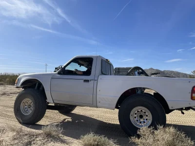

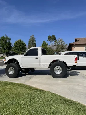

1994 ranger with a 2.3 and manual trans, 8.8 out of an explorer custom unequal length beams with camburg shock hoops and engine cage running 16” 2.5 king coilovers. Has a cab cage and some old school corbeau seats the rear has a super simple bed cage with some 16” 2.5 3 tube bypass and a 30 gallon fuel cell behind the axle. 15” alcoas off a bronco and 37” tensor dsr’s “the best tire I’ve ever ran” trying to keep this thing as og 90’s pre runner as I can. I can post more pics of fab and what not that I’ve done on the truck if more people are interested.Heck yeah it's cool. What are the specs on this bad dog?
