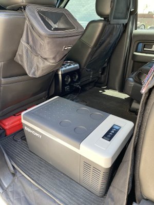

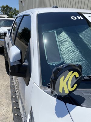

So funny, I was just going to make a post about this. The fridge I used on the last trip was borrowed. So last week I bought a Euhomy 19 qt fridge cooler off of Amazon (they are on sale right now BTW). https://amzn.to/3XASy2T I have a little battery bank that I brought with me on the trip to use with the borrowed fridge. My plan was to plug the bank into 110 power in the truck so the bank would charge while the truck was running, then power the fridge off the bank battery when the truck was off. It worked well for about a day and a half. The problem is it takes like 8 hours for the power bank to fully re-charge so it could never catch up. Now, I’m trying something a little different. With the new fridge I bought a small solar panel that plugs into DC power and suction cups to the windshield to trickle charge the truck battery while the truck is off, with the fridge plugged into the DC outlet in the truck constantly. I’ve tested this for about a week and it works good so far, even leaving it on over night. The cool thing about the fridge is it has a battery protection mode so the fridge will shut off when the battery volts drop passed 10 volts. It’s set at 38 degrees with adult sodas in there and they have been ice cold every day.
great info... i wanna do something similar... i have 2 batteries in the truck, but they are small... so its plausible to run a battery pack off a battery and if it kills the battery, I still have a 2nd to start the truck. I am curious you said your fridge is 19quart? i was looking at this fridge as I need something narrow to fit between the seats... but says its a 53 quart... what is actually needed?
53 quart?
yours looks huge for 19 quarts, or mine is going to be massive and wont fit. lol
EUHOMY 12 Volt Refrigerator, 19QT(18L) Portable Refrigerator Freezer(-4℉~50℉), 12V Car Fridge Cooler with 12/24V DC & 110-240V AC, Compressor Electric Cooler for Camping, Travel, Truck, Boat, Home.​
This is the description from the one i bought. a 53 quart has to be huge lol
i ordered a 43 quart fridge and should fit perfect i think. lol got my seats on order, so in a month or so I will know... Now I need to find a battery supply I like.
ive been tossing the idea of putting one in my ranger but idk, that looks pretty big for 19 quarts. I need to do some measuring.

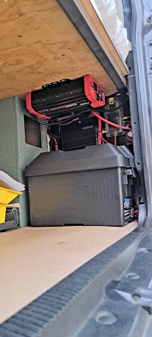

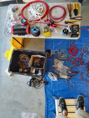

this van build has been a learning thing for me.
