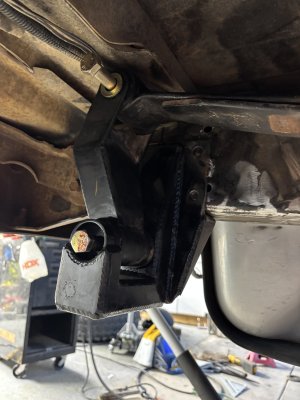

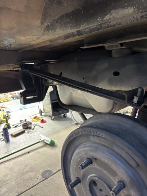

Hey guys. I have a 1986 bronco and am installing q80 deavers with a 3.5 drop hanger and 7in shackles. I’m trying to figure out the leaf set up as far as bump zone and shackle angle. How much negiti e arch do you guys have? Are you guys running the stock bump stop and not dropping down the bump zone? Can you post pictures of your shackle at bump and droop please. Thanks the pictures are not full bump will go up another 1in or so

I don’t have any pictures of my leafs at full bump,
I want to say it’s about flat, maybe a smidge negative.
I would say set it up for clearance on the tire in the fender before worrying about bump stops and negitive arch.
Throw the tire on and jack it up to where the tire is about stuffed and call that full bump. Now you know where to set your new bump stops. Or if you don’t like how the leaf spring looks, extend that bump stop a little more to get rid of the negitive arch.

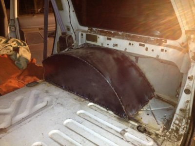

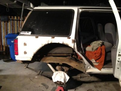

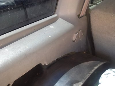

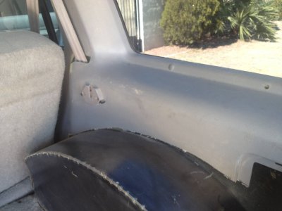

or be a man and tub the fuck out of it like i did on one of my old explorers.................

Can you post a pic of where your at ride height and what your bump set up is. I know Toyota leafs really well this is my first time setting up these kind of shackle leaf
my suggestion is like Tree Trunk's,
first = get rid of the stock bump stop. unbolt it, and throw it away.
then......... if you already have the shackle/hanger you plan to use, bump it out with the axle touching the frame (or whatever is going to limit you first thats an absolute positive) with a single leaf in the pack & using the proposed hanger/shackle, don't worry about the shock YET, then post pics of the bumped out leaf/axle/setup. then we/others can give you suggestions on where to go/what to do next
