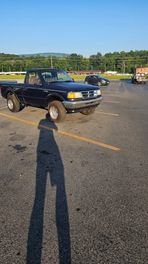

Have done ton's of research on the front end, cut and turn, extending, etc. Im just wondering what you guys are doing in the rear? I've heard of the deaver leafs, chevy 63's, linking could be an option in the future. For now I just wanna stick to somewhat of a budget. Also what rear end you guys running? The stock ranger rear end? I've seen a couple posts about the explorer 8.8? Sorry for all the questions, just want to have everything together so I can get started on it this Fall. How much lift does the cut and turn on the ttb account for? I know for a fact 4 inches, but will I be satisfied with only 4in of lift? Last and final question how are you getting the width in the rear, is the 8.8 Explorer rear end wider? Thanks in advance!

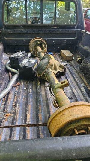

Picked up this 8.8 rear end today for cheap i believe it measured close to 66" from drum to drum. 1 step closer! I believe I'll be going chevy 63in leafs for now, unless I find a nice set of deavers close to me thats reasonably priced. Thanks for the help!

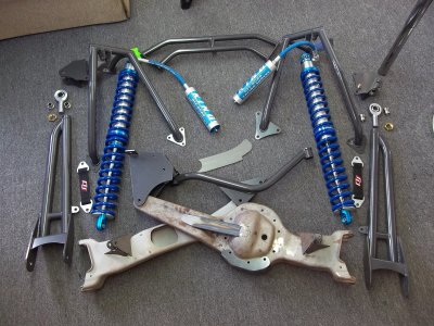

I could write a book about my ranger, but to keep things short i ran a 8.8 out of a 2001 ford explorer sport. Disc brakes, ford racing gears with posi, 31 spline axles, 3" overall wider than ranger 8.8, and i added a Artec Industries axle truss. Moved rear shackle hangers back, old Deaver f23s out back, 14" 2.5 king triple bypasses, cut and turned stock width TTB up front with 2.5x12" coilovers with GIANT motorsports engine cage. My transmission x member was where the extended radius arm pivots were with heim joints. Truck worked amazing. If i build another one im going this same route. Truck surprised a lot of people.

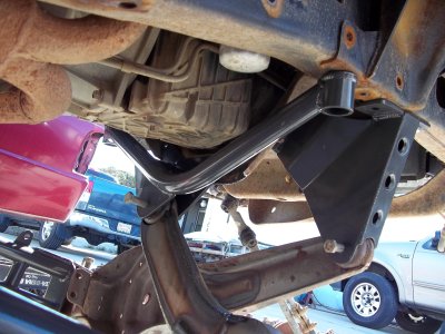

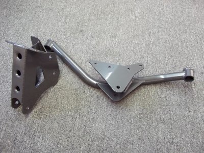

If you do the Dana44 that are 6" wider, I have the conversion pivots and Radius arms and then you what the 80-96 F-150 8.8 axle so it will match the 5on5.5" bigger lug pattern of the D44 front.
