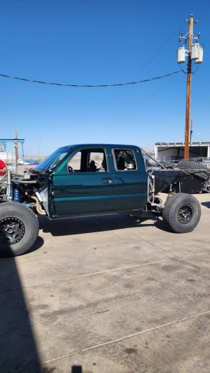

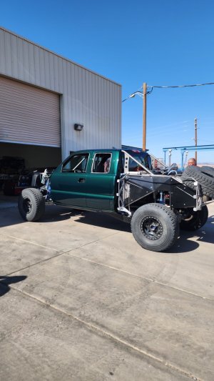

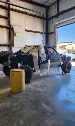

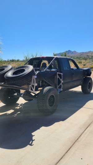

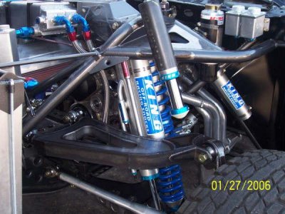

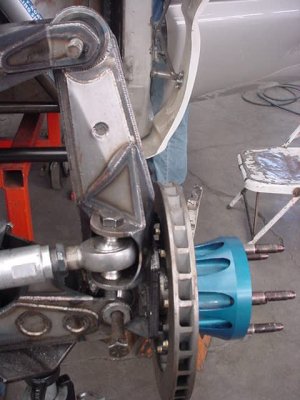

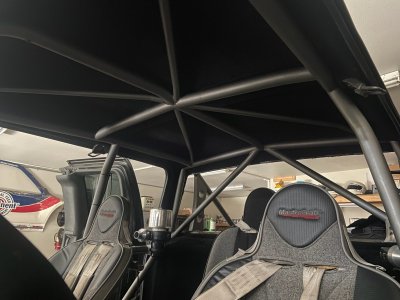

Curry build from early 00's. I've been rebuilding it with the help of some friends. The truck was in rough condition when I got it, wiring especially. Pulled the headliner at some point and found that there were some tubes not fully welded. Started pulling interior and cut some of the body panels off to fix/add tubes. Here's some pics of the original build and current, unfortunately don't have many pics of when it was first built.

what front hubs are those? Look remarkably similar to the tubeworks ones on my rear
