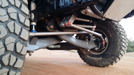

I machined four poly bushings I had in the shop that already had the correct ID. Here is a picture of the day I finished it.
Two at the spindle and two on the swinger. They push on by hand and are a little loose so the heim does move. Absolutely no problems with this.
I remember it being recommended for years on DR by so many so I tried it and it just works well.
