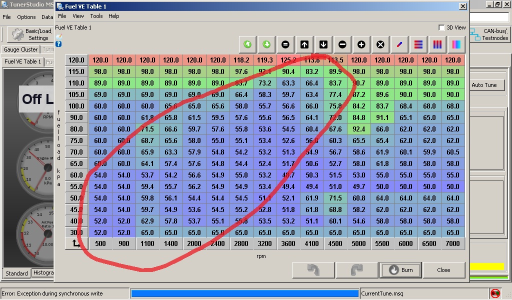

i have run the VE table up a little, up a lot, and ridiculously lower than it should ever be. all the same result
the VE autotune got the cruise great pretty quick so i feel like driving O2 is accurate but the power side just doesn't play by the rules!

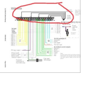

as i am sitting in the 100 degree heat looking at my under the dash wiring i noticed i never ran any ground wires on the expansion board. i guess once i got enough to start the engine the first time and it ran great i stopped wiring in circuits
now it runs all the way up in the rpm and the wall is gone
