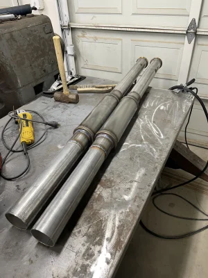

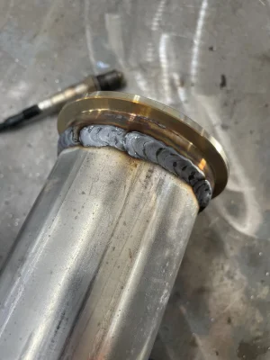

I just did these for the start of my F100 exhaust.

Hell yeah that came out nice I should have asked this question before buying the materials I would have bought better materials I was concerned with using mig
95% of cars on the road have aluminized exhaust and are mig welded. Stainless and tig welded exhaust wasn't even common until 10-15 years ago.
What you have is fine and will last a long time.
