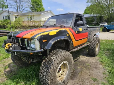

A literal pile of garbage, 80 toyota pickup.
Trashcantoyota
Jun 6, 2024
7
More so a trail truck than anything, but gets the job done most of the time.
As of right now....
80 pickup body
Front half of an 85 4runner frame, some steel tube, and the back 14" of the original 80 frame.
8" axles, yukon front, detroit rear, some fancy axle shafts, and some brakes from a montero (? I think)
Rears up front, 63s out back.
11.5:1 cammed 3rz
A 5 speed toyota trans that was in some weeds
Dual cases
And you can't forget that can do attitude.
Considering going with a fabn801 chassis, keeping it small, and drooping dome weight.
