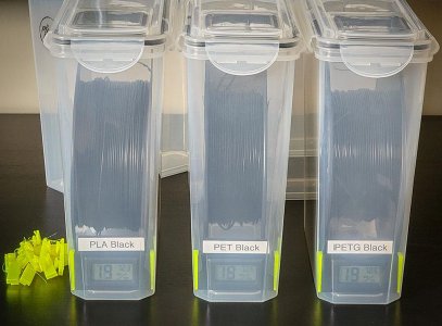

Bodj recently asked about printing PETG and I have struggled bigly for quite awhile before finally figuring it out. The biggest issue is that it sucks all the moisture from the air and makes it stringy and globby enough to ruin your print.
My basic approach for printing:
-Build box around the printer with door to keep heat even. My box is wood to stabilize humidity further
-Place the filament in the heated environment. The extruder does a decent job lowering humidity in a closed space, I've seen 15% inside when 35-40% ambient humidity. I have holes drilled in the top of my wooden enclosure and a trash can covering the reel, pretty basic but works.
-Store filament in a plastic cereal box with dessicant beads to keep dry. This actually dries the filament albeit super slow. Mine read 10% humidity after a couple hours and have stayed there as long as it's been closed.
-PETG specific, reduce bed temp to 40C after first layer to help with elephant footing and base warping.
https://www.amazon.com/DWËLLZA-KITC...917667&sprefix=cereal+bo,aps,163&sr=8-43&th=1
https://www.amazon.com/Desiccant-In...prefix=blue+desicant+bag,aps,163&sr=8-11&th=1
https://www.amazon.com/Hygrometer-H...918546&sprefix=humidity+sensor,aps,197&sr=8-6

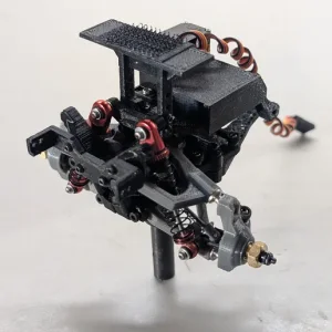

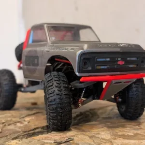

Shameless plug while this thread is bumped, I released an IFS design for the SCX24 that I've been tinkering with for a few years now. Clearly not a resounding commercial success, lol.
https://cults3d.com/en/3d-model/game/scx24-independent-front-suspension-4wd-ifs-kitPXL_20250726_022513217.webp

I used that same container to hold my open filaments!

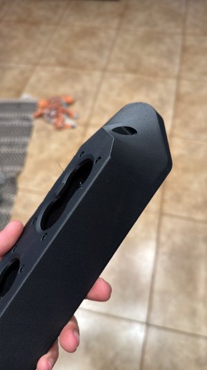

I’ve been using petg cf on a few test pieces and I really like the cf surface finish. It prints pretty easily if you have a big part but the smaller parts tend to lift so a little glue helps.
I just picked up some Asa cf to try out since it’s more uv and heat resistant with properties similar to abs.
Abs is probably my favorite to print but I don’t like the look of the exterior walls so I’m hoping I can get the asa cf to work well
Here’s the petg cf surface

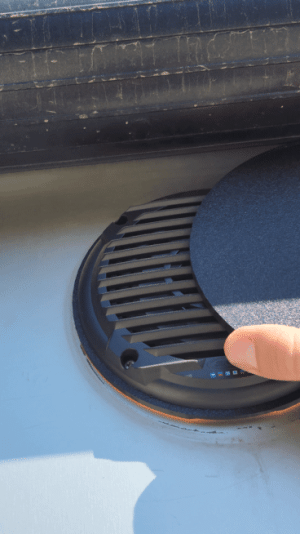

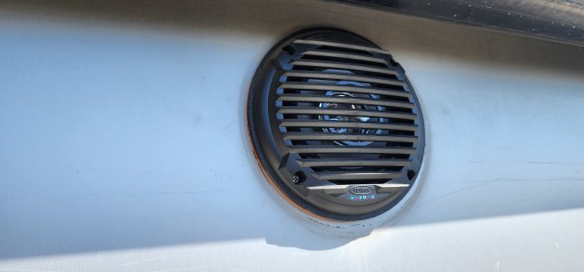

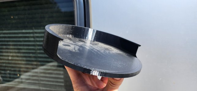

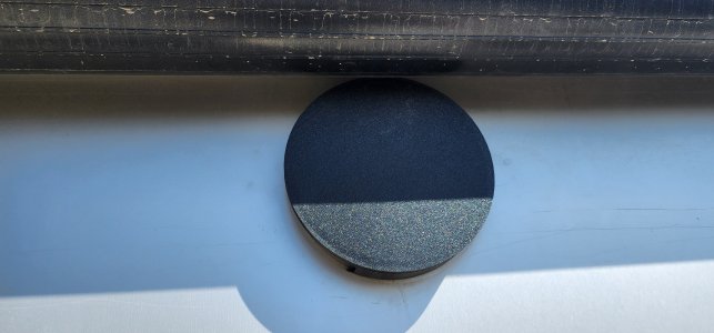

This is a little ABS project I did, basically its a sun shade for my trailer speakers when its parked at my house. There is a base that goes uper the speaker then the cover slides on.

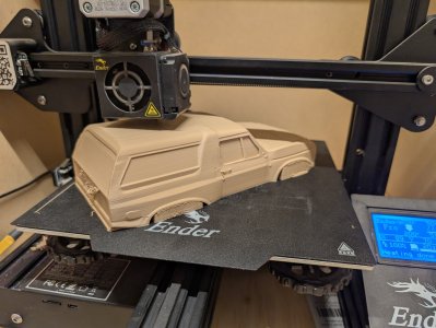

Inspired by the AI model thread I took a photo from fiberwerx website, cleaned it up a bit with Gemini, and used Rodin to create a 3d model that I scaled and printed for an SCX24. It got remarkably close for me doing no real work. They have a multi photo option that would help get it closer but it's a paid subscription.
Wait, what!?

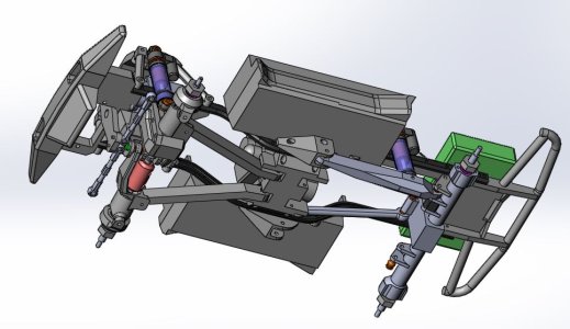

Bronco is all finished up. Asked Rodin the AI politely to model a bronco based off a Fiberwerx picture, scaled to fit on Cura slicer, designed the TTB chassis, and put it all together so that I realize I don't know how to build TTB steering and my son could break it repeatedly. Fun little project though.
