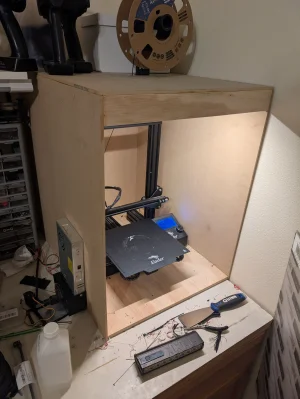

@Motiracer38 Do you have any pictures of your wood enclosure? I am thinking about building one out of cedar.Bodj recently asked about printing PETG and I have struggled bigly for quite awhile before finally figuring it out. The biggest issue is that it sucks all the moisture from the air and makes it stringy and globby enough to ruin your print.
My basic approach for printing:
-Build box around the printer with door to keep heat even. My box is wood to stabilize humidity further
