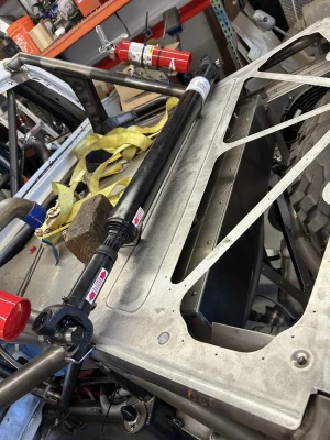

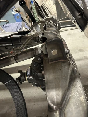

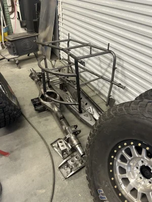

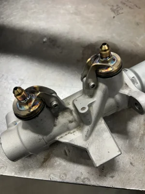

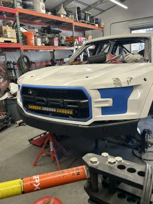

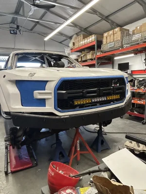

The housing is custom. The third member is from strange engineering….Richmond gear 10” with 5:14’s in a gear works inc 3.8135 case w/ 40 spline HDX with spool and 1350 yoke
