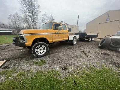

1977 supercab Cummins tow rig
I love this truck! I want go build one similar to this but a 4 door. I have the engine, but no truck yet.

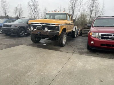

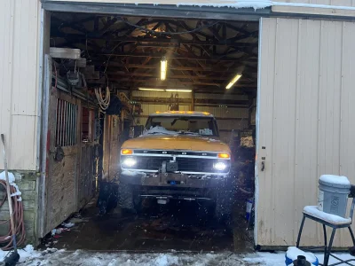

Well we got some snow on Monday so I put the truck in the barn and installed my new led headlights. It might be old but I will at least be able to see at night when I drive it now. Lol

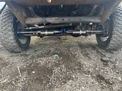

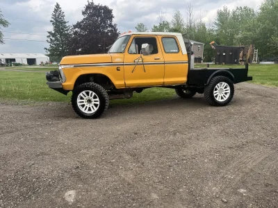

Slowly picking away at things. The bed is all welded up need to add some bracing for the sides and grind some stuff off. Also added some 7” hids I had laying around. Next will be the dual steering stabilizer set up I got dirt cheap after I make a bracket to match the missing one.

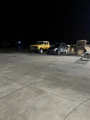

Drive this down the eway for the first time 70 mph 2300 rpm 5 lbs of boost I can take my hands off the wheel and she goes straight it drives out great!

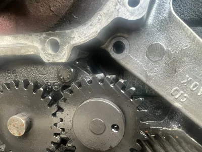

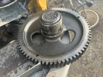

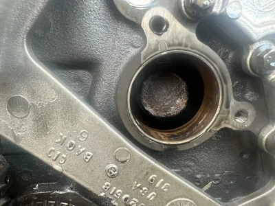

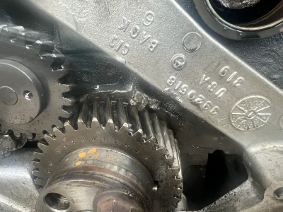

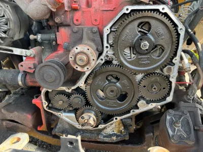

Haven’t posted much on this put a few miles on it and one day it went pop and shut down. I brought it home and broke some ribs a few days later then went on a 10 day vacation to our sand dunes here in michigan got back home and tore it down and found the problem. A bolt came out of the timing cover and broke the cam gear off. No damage to the head or pistons fortunately. I’m ordering a new cam lifters/tappets and going to upgrade the push rods will it’s apart.

Sounds like the “killer dowel pin” got you. Sometimes it will fall out when driving but ends up in the oil pan without any damage. Other times it’ll do what you have experienced.

The wait for parts is finally over cam and tappets showed up last week head gasket showed up Friday and new push rods showed up yesterday 8-21-22 finishing cleaning up the engine and painting today drop the head back on tomorrow. Kdp block off plate installed as well as removing all bolts inside the timing cover applied lock tight and retorqued them. Pulled the oil pan and cleaned it all up made replacing the tappets easy! That’s all for now hopefully have it back up and running this week.
