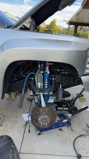

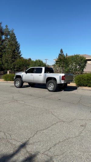

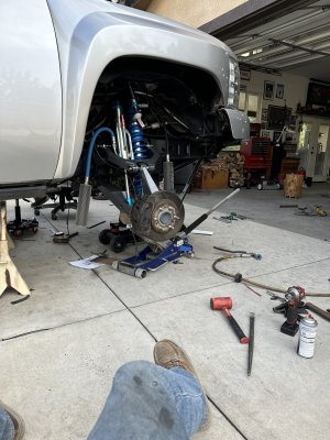

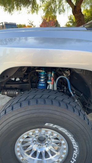

@LoganWC34 I recently picked up a mazulla lt kit for my 2013 Silverado. It took me a long time to get it, but I was dead set on getting his kit. Mazulla has been in the off-road world a long time so that was my deciding factor. To be honest the kit is awesome it is a lot of fun. The rear of my truck has a simple bedcage with shackles, hangers, u182 leafs and it awesome for what it is and with the stock 10 bolt. Wish I could give you more info on the pros and cons of both companies, but mazulla has treated me well. Every time I call he pick up. Also I’m on 39s with 17s. I’m running a 2.5 coil and 3.0 bypass.

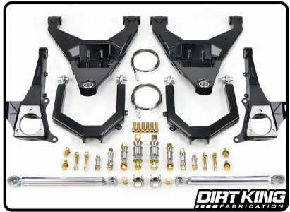

We offer a Long Travel Kit for those. Pretty standard specs amongst other manufactures (4.25" wider per side, 17.5" wheel travel, 2.5 coilover, 3.0 bypass and 2.0 bumpstop, Heim steering etc) If youd like more info or to get BLGT pricing feel free to send me an email ngardner@dirtking.com
