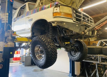

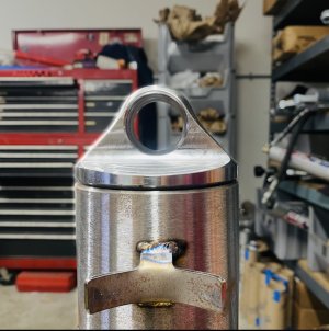

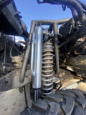

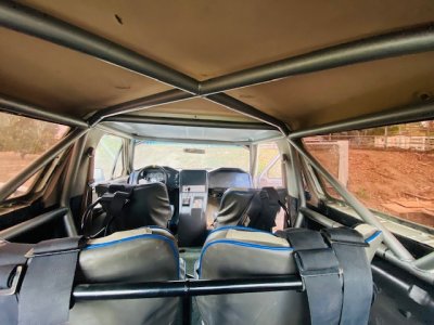

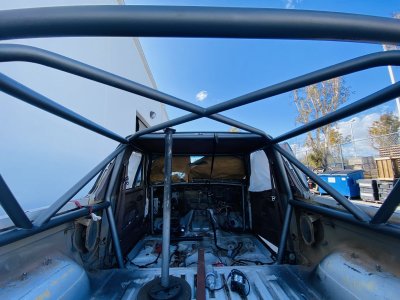

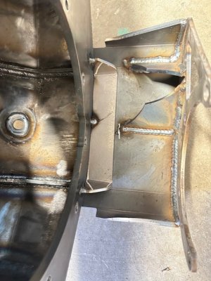

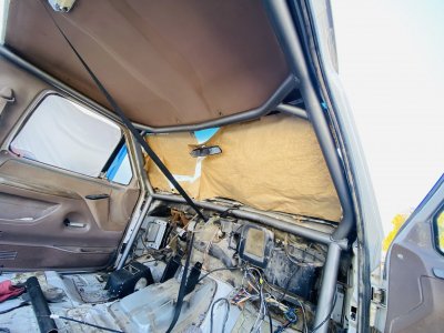

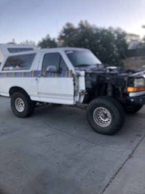

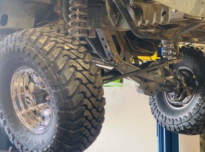

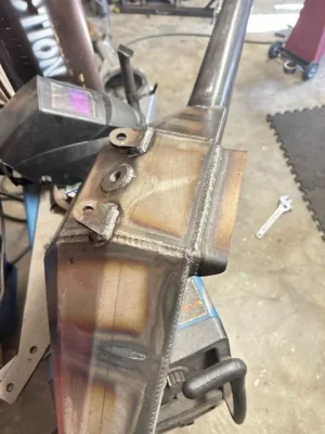

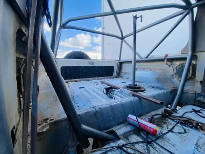

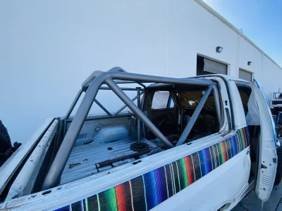

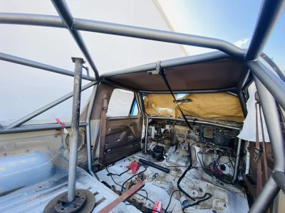

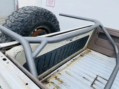

3-4 years ago Dustyn Loppnow put “The Stocker” together for me on a trade for some Solid Shocks. He did did all my Giant parts with my Solid 3.0” IBP coil overs and 4.0” single tube by-pass. We beat on the truck pretty hard until the body started cracking all over the place with the fenders and hood falling off. Ethan and I welded up Andrew, WIY cage in the back and I did the front “A” pillar. I’ll post more as I go.

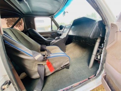

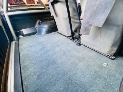

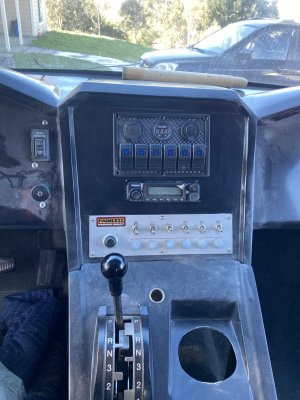

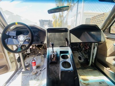

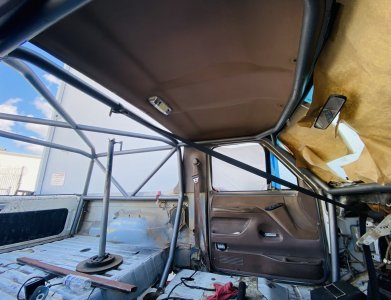

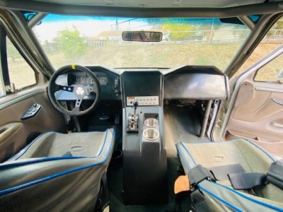

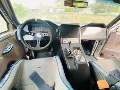

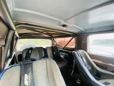

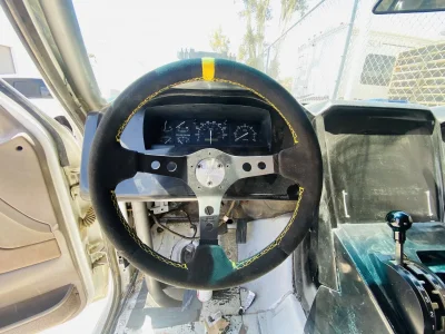

I got some work done on the inside.

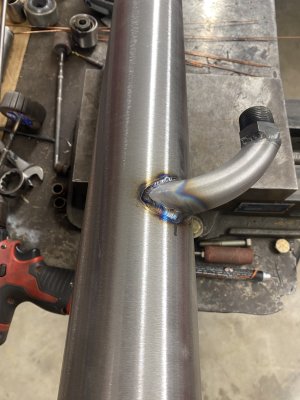

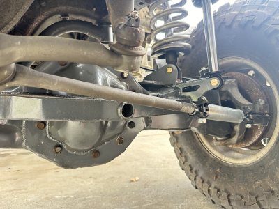

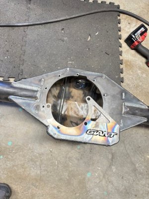

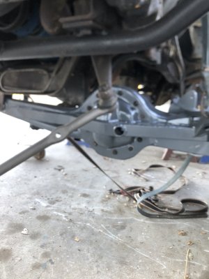

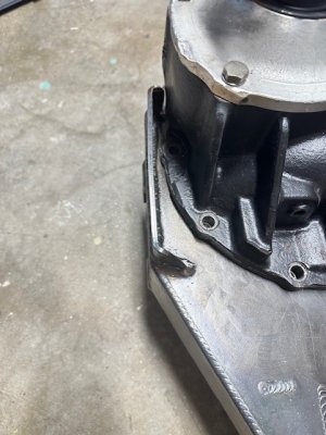

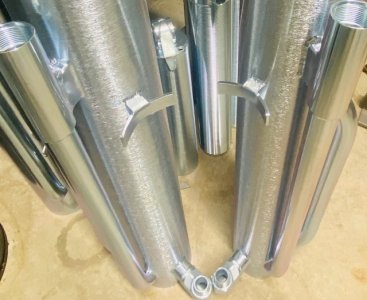

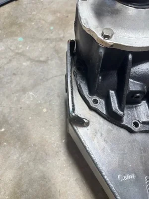

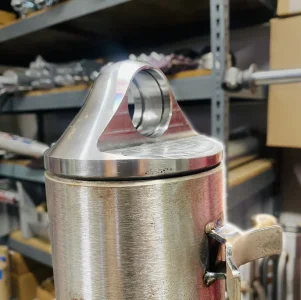

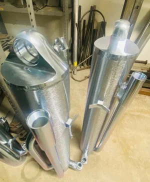

Got the rear 4.0" back from the Zink Plater, man they look good! Started building up a 9" with a Giant Skid Plate and bonus guard.

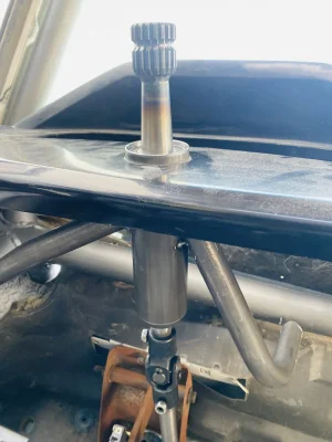

I know this is calling back a year old post, but who makes that steering column bearing arrangement? is that a Giant product?

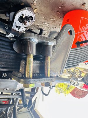

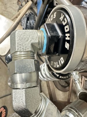

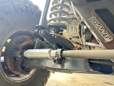

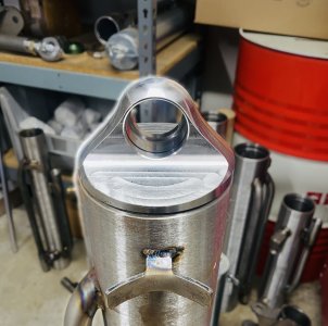

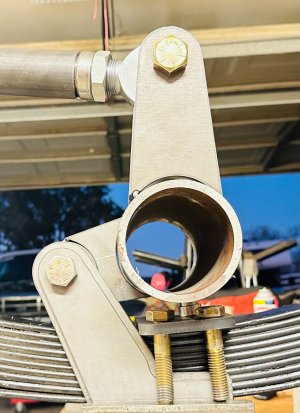

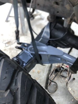

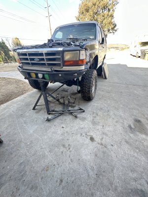

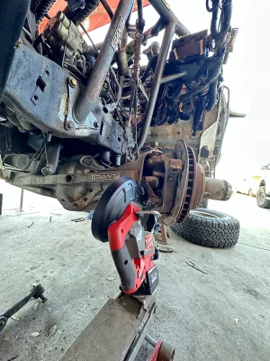

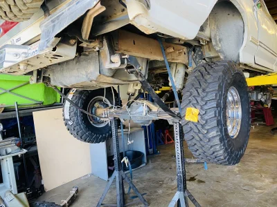

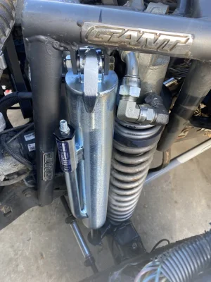

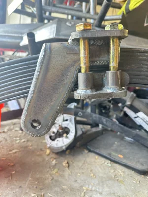

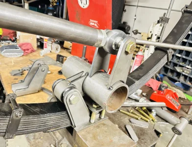

I got the shocks finished, mounted and sitting on its own weight. I’m working on a new floating leafspring perch. Here are the features I am aiming to achieve: U-bolt eliminator, takes different loads off the springs, adjustable pinion angle, eliminates axle rap.

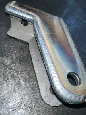

I was out of town for a week, but I did get some of the parts welded up before I left.
