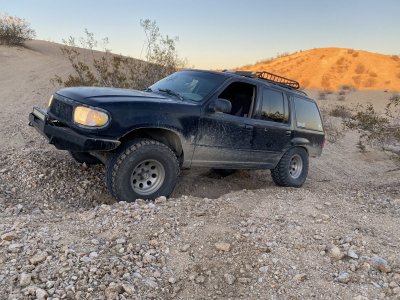

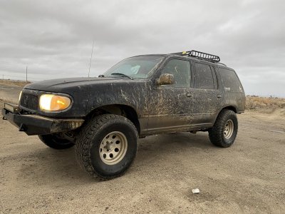

Figured I’d document what’s done on my 2000 Mercury Mountaineer 4wd v8. When I got this from a friend it was sitting on 32’s with minor front fender trim and RLC Fab front bumper, warrior shackles and cranked torsion keys.

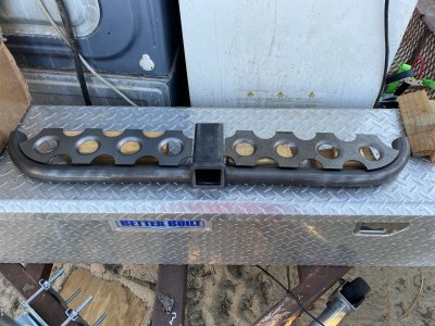

I purchased a diy rear bumper step from ruff stuff but haven’t decided on tube or plate for the main support

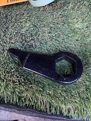

I purchased a set of torsion lift keys and put them aside

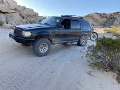

Shortly after I went up to 33’s as 32’s were impossible to find used near me and I had some 33’s laying around for my Chevy.

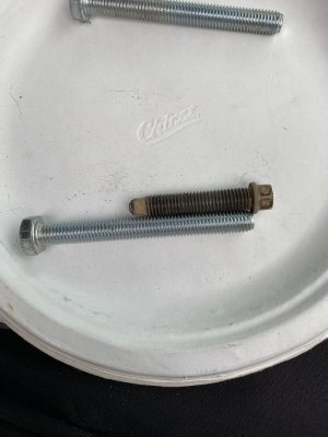

I went to install the torsion keys I had ordered months prior to find out it already had a set installed. Did some research and installed longer torsion bolts to regain some lift from the sagging t-bars.
Now that I have the desired height regained I will order new bolts a bit shorter so they don’t hang out at all and do flange head like oem and grade 10.9. I gained about an inch of lift with the longer bolts after a decent test drive yesterday.
Next on the list is decide the rear bumper and find a matching set of 33’s and possibly new shocks.
