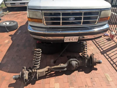

In the process of building a 1996 F-150 for camping and romping around the East Coast. Threat motorsports is doing the kit - cut and turned beams, radius arms, deavers in the back with 5100's (for now). Doing a refresh of the steering as well, knocking off all the surface rust and, and putting in a set of cheap corbeaus I found on marketplace. Once I sort the suspension out I'll be building a little pop up camper out of extrusion. Probably will keep the stock wheels and bump up to 33's and if I find I need more travel/shock adjustment, I'll step to kings and the threat coilover bucket with the under the bed shock hoop for the back and maybe 35's. Still waiting on parts right now, but I'll keep this thread updated as I finish work on it!
Forgot to mention some background on the truck - its a 4x4 supercab short bed that I got for less than $3500. It was a one owner and has 271,000 on it, but was really really sound and had almost NO rust for the east coast. Bought it from an old guy in Baltimore. There is an issue with the rear tank sending unit (not reading correctly, so I'll be testing and replacing that). I haven't tested yet the front tank yet, but if I go to an under the bed shock hoop I'll have to pull it out anyway, so I'm thinking that's going to stay as is for now, good or bad. This is my second 1996 F-150 so I'm fairly familiar with these trucks.

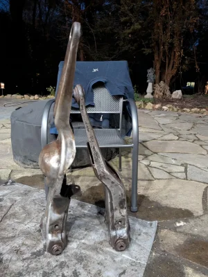

Taking a couple days to prep and paint all the big stuff - got everything but the beams done today, which I will hit tomorrow. Using seymor stainless, which I saw someone here call seemore butts (the name I'm using now). Bolts are in as well, so hoping I can have the front end back together before July 3rd.

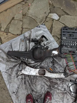

Made some more progress on setting bearings/seals/ball joints, test fitting and generally getting things back together. I may have spoke too soon about the lack of rust on the truck as the coil buckets had their coating peeling off. I checked the frame behind them and everything is solid so I just wire wheeled them and hit them with rustolem rust reformer. Gives me an excuse to step to big boy coil buckets later on.
If anyone on this site has a threat kit or might know anyone who does, can you let me know how the new radius arms bolt onto the ttbs? I have pinged Dave but no response yet. I'm not sure if there are any spacers, or if I need to bend/reuse the stock brackets that are co-mounted with the stock radius arms. I did have to drill out some holes on the radius arm mounts to a 1/2in as they were just a little bit small.

Shouldn’t be any spacers (throw the stock stuff away) The new radius arm should “saddle” the I beam, and you can use the factory bolts to secure them to the beam.
Thank you! As the new radius arms don't fit perfectly I'm assuming there is some compliance (the mounting ears of the beam will flex to fit the ttb)?
Need to turn down the bushings for the TTBs....
Took some measurements today with calipers and will be going to my godfathers tomorrow to throw them on his lathe. Tried to take a grinder to them but they need to be knocked down quite a bit. My measurement for the pumpkin ttb was 146.5mm and 148mm for the other. Probably will go .5mm under for both sets just for the sake of assembly (unless there is a reason not to).

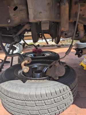

Front is pretty much done with bolts tightened - VERY glad the brake lines went smoothly. They are in decent shape but needed some heat to free them up. I ordered the wrong tie rod from moog and may have blown out my power steering pump when I was centering the wheel.... Hoping its just leaking out from the cap but I'll see when I get this on the ground. New tie rod comes in tues to finish the front up. In the meantime I'm knocking rivets out to replace the rear shackles. My seat bracket from corbeau also doesn't fit either so I need to shorten that as well.

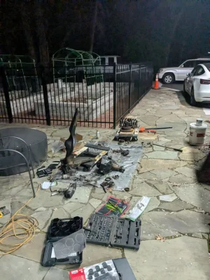

I FORGOT HOW MUCH I HATE RIVETS - 8 rivets fought me for 3 hours today, I dont have access to a oxy torch and it probably would not have been a good idea to use it there anyway as the gas tank is right behind the frame in that spot
Last week I had to sawzall the leafs out as the sleeves had merged with the bolt - that sucked as well

Go buy yourself a HF air hammer. Sharpen the chisel before using. Cut an X in the rivet head with an angle grinder, and then use the air hammer chisel to knock off each quarter of the head, like removing a pizza slice. Each rivet should take less than a minute or two, to be honest.
Funny, that is usually what I do (I try to make more than two cuts in the rivet), maybe I need to hit the weights bc that usually takes me at least 10-20min each rivet, including getting out of the frame. Maybe my chisel needs to be sharpened?
Sharpening it made a huge difference for me. Once you pop the head off, use the air hammer to knock the rivet through the frame. Only time I've ever had an issue is if space is tight.

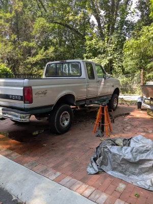

I have a truck that is sitting on 4 wheels again! I did have to drop the gas tank, but forgot to detach the filler neck/drain the tank so the tank dumped a bunch of fuel into my parents yard - but it totally missed the garden so they didn't care. Took that opportunity to replace the old filler neck and rubber connecting hose.
I'm going to drive it as is after I finish the following to work out any other kinks in truck:
Diff fluid (front and rear)
Front driveshaft U joint
New diff vent lines
make sure my power steering system isn't hammered (refill/rebleed)
put the original bench seat back in
extended rear brake line/brake bleed

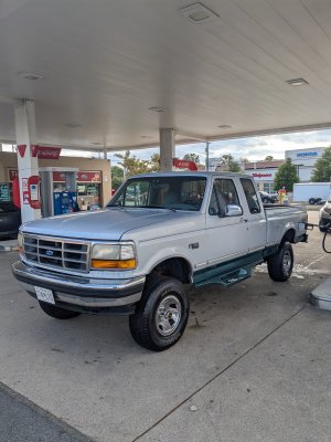

Solid downgrade from my lx470 - the skyjacker springs that came with the threat kit in the front are terrible (sprung way too high) and the 5100s seem to be better on fast hits than slow, but I'm going to drive it for a while before I start messing with it again. It definitely needs a new steering box/shaft if anyone has any recommendations (borgeson perhaps for the shaft). Probably going to use it to move this weekend so I'm glad I still have AAA haha
I was waiting to see how you liked the front coils, they are supposed to be 560lbs/In is what Skyjacker told me.
They are awful, I cannot see how they would preform better on trails - my truck is a 5.0, maybe that spring rate for a diesel makes sense, but they don't seem to be settling in well either, although it hasn't been a lot of time.
