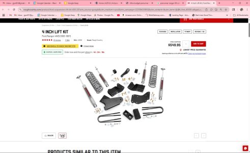

ok so I'm not quite sure what "reputable" means is the rough country 4wd 4in lift kit alright? it doesn't come with radius arms or drop pitman arm but it has some other things like springs and shocks that are technically "upgrades" just I'm new so I'm not sure what the big names around here are.

anyways.......... all you need to look for for YOU is just (someone else correct me where im wrong/missing something):

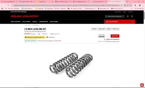

a taller "lift" spring:
this kit from Rough Country is the whole "kit". but they do sell just the springs.

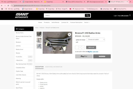

Radius arms & brackets for the radius arms:
(these are brand new from Geoff. and for an F1, NOT A RANGER. they look the exact same) but so you can have an example. classifieds somewhere always has some...........

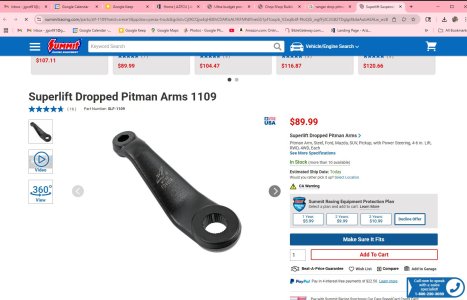

a drop pitman arm..... (you dont NEED this to make the truck driveable, but to get it aligned, cycling the suspension right and driving nice, definitely needed)

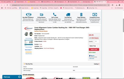

extended brake lines and alignment cams for the knuckles
