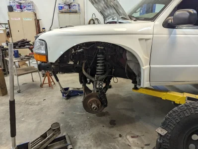

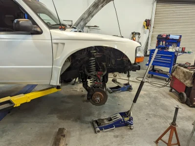

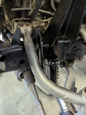

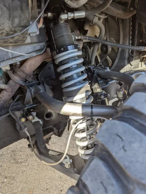

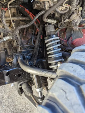

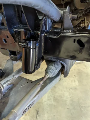

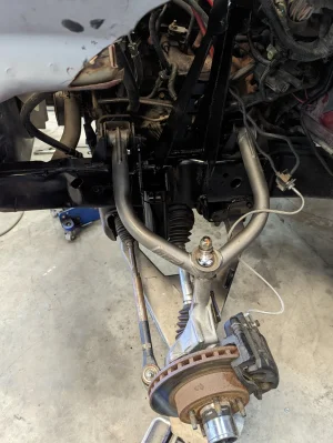

Got the front air bumps, limit straps and brake line tab mounted up. Painted and ready to reinstall everything BUT first I gotta do tubing for the inner fender delete that's happening for clearance at full bump.

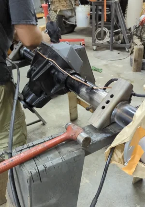

Truck is driving and out of the shop. Tomorrow a 99 Tacoma comes in that I'm going to swap the motor in for a friend. Stock truck but it's a friend who I'm helping out since I found a good motor and will get it swapped for a good deal compared to regular shops that she was getting a quote from.

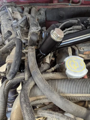

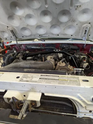

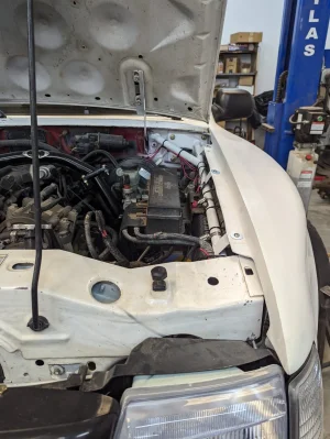

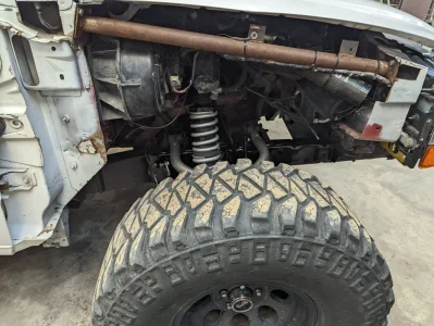

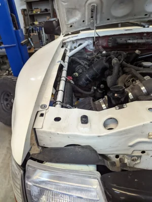

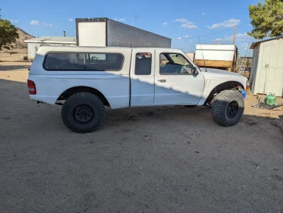

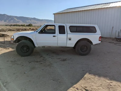

Well got new tube inner fenders on as well as fiberglass and adjusted the hood a bit to better line up. Trimmed fiberglass for full bump. Made mounts for fuse panel, clutch reservoir and zip tied up all the wires. Waiting on windshield washer reservoir to arrive. But its finished up besides that, alignment and driving to break in the new gears.

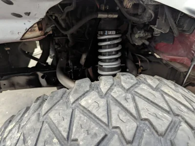

It's bumped and strapped at 14" travel. Straps are new so right now it's around 13.5" before the stretch and break in.
Yeah cycles good and pushed forward clears firewall. Had to trim about 2" of height in fender for bump but not bad really. Plus this truck has manual hubs so no need to worry about vacuum shit working or not working.
