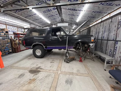

-“Paint matched” fenders and hood…
-Towed in the the front tires about an inch, it tracks much less terrifying now lol still about an 1/8th out.

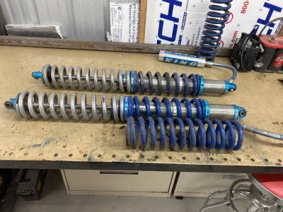

Im pulling the coilovers for a spring and valving change.
I’m currently on a 500/550
I’m going to try these 450s that turboyota let me borrow. For a 450/550
I will also be using the cross over nut this time around.
As for valving, I know I have a pretty aggressive flutter stack in it right now. I’m going to see if it has some bleed holes I can open up then return to a less aggressive flutter stack or even work towards a regular light pyramid.
The goal is just like everyone else’s… keep it plush over the chatter and firm in the big stuff.
It actually worked pretty well as it was, but after some big whoops the water test showed the bypass was working way harder than the coilover. So I’m hoping to spread the load

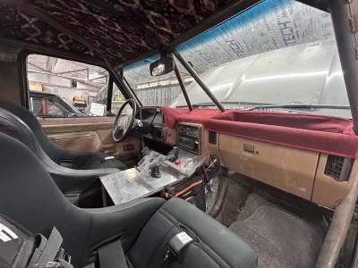

I also installed this clean ass dash mat, some USB ports and an iPad mount.
The iPad mount was good for the co-dawg but it was annoying to me that I couldn’t see the map. So I will try and hang it just above the air controls.
