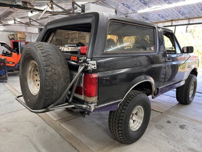

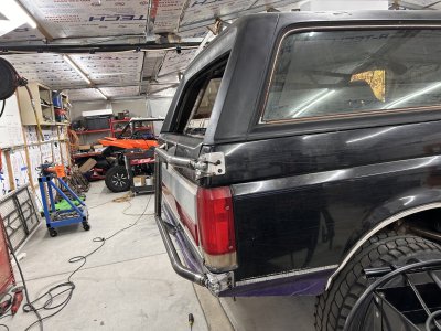

Been working on a tire carrier the last few days.
I set it up so I could carry a 37x13.5 if I ever needed to carry a 13.5” tire…… Looking back I think that I didn’t need to do that and I think it made the tire rack look kinda weird with a 35 on it.
I’m going to strap it instead of bolting it down…. Still waiting on the weld on clip rings and the strap to finish it up.
Also set up a dust light.
Time will tell if it holds up
Nicely done. For me I would add a small flat pad where the carrier meets the lower bumper area right above the license plate. Put a delrin pad on the bottom of the swing carrier which lands on the pad to support the weight, when the carrier is open you can use the pad as a small step to get things from inside without having to drop the gate. I've fixed a few carriers this way after they started tearing the steel bedsides off, haven't had a problem after the pads where installed.

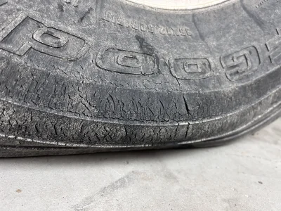

I came across some wheels and tires
Anybody got a guess for what they are??
