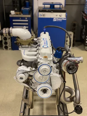

I am open to doing an engine swap in my 1982 f250, it currently has a ford 400, that needs to be rebuilt. Before I spend money, I have this itch to do a Ford 300 with a turbo.
Is this a bad idea?

Great idea. I had a 300 bored with a cam and larger valves with opened up runners and higher comp ratio. Next would have been a turbo. I didnt get to dyno it because the truck got totaled in a crash during the break in period.

From what ive read and remember on mine it uses the small block bellhousing. 300,302 or 351
It’s one of the longest lasting, best engines ever made period. You pretty much can’t kill them, and they have been used in everything from trucks to tractors to pumps to farm equipment. They have a decent aftermarket support, the later model engines (4.9) have fuel injection, and quite a few have made custom 6cl LS heads work. Don’t expect it super high revving but they make a ton of torque
It's a standard small block bell housing. They are great engines, lots of low rpm torque. They just don't like to be revved up like a v8.
