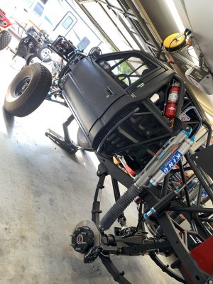

what gears are you gonna run??? and do you know how fucking light those 37s are? seriously asking. ha

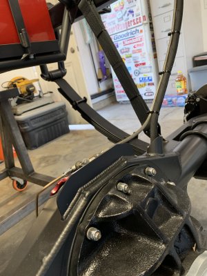

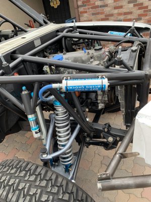

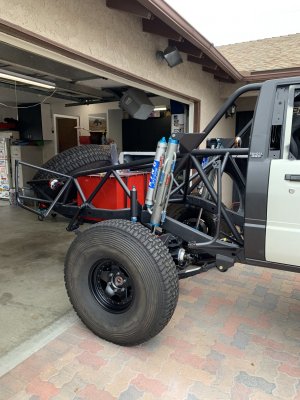

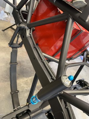

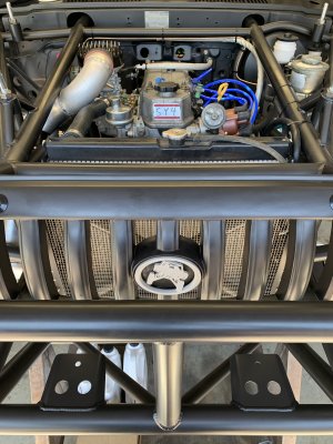

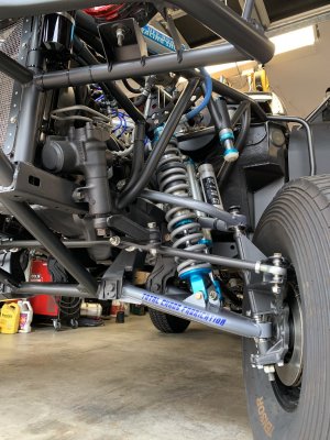

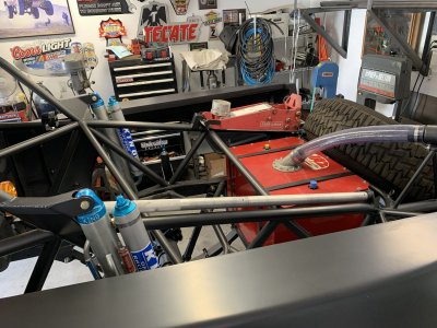

Been running the DSR37 on these cars for the past couple years now.
It has a a 6.33 ring and pinion in it. And yes I know all about the tires. I have thousands of miles logged on them on multiple race cars.

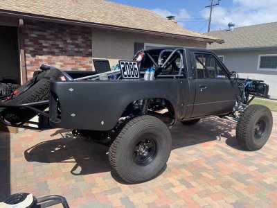

Yes. The wheel/tire combo is 72lbs the wheel is a 15x7 AR23. I ran the same gear ratio on the old truck 20 years ago. The difference is that truck had 35x12.5 Baja t/A’s which are heavy as fuck. The 37” tensor is 20+ lbs lighter than that 35” BFG

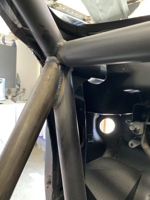

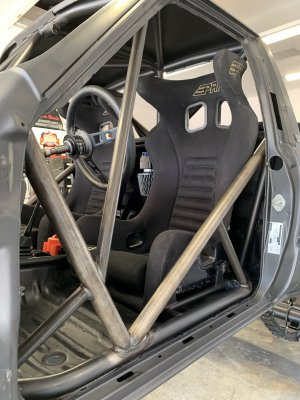

Mas fotos

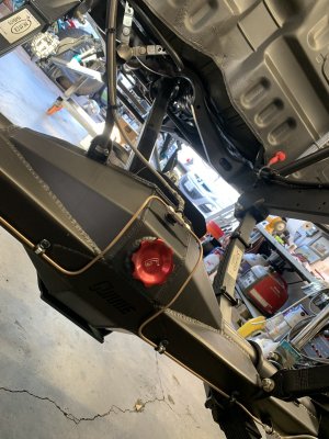

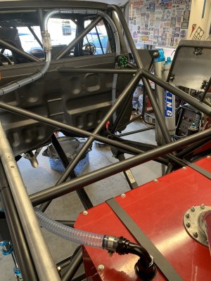

Mas toobz

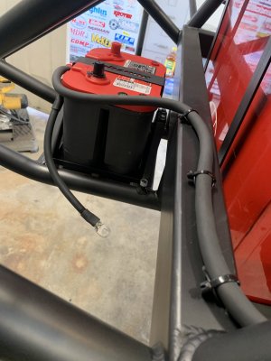

Mas

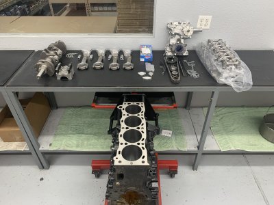

Alright guys that’s about it for photos from the last 2.5 years of this build process…… I do have 3 more to share tho. Got these photos on Thursday from Brian at LC Engineering. Completely new engine coming together as the other engine turned out to be a complete nightmare. No stock parts going into this build.
