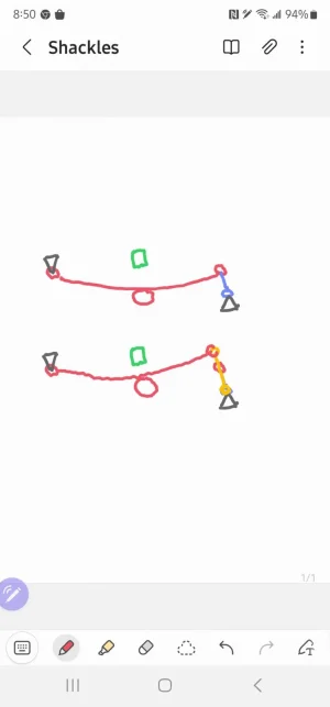

If l lock it all in with a 6" shackle then later decided to change to a different length shackle will there be much effect on the strike location of the bump stop and or the full bump location of the shock?
The reason I am asking is I have the feeling my truck will sit too high with my leaf/shackle set up and may lower it with an extended shackle in the future but would like to permanently mount the shocks and bumps now.

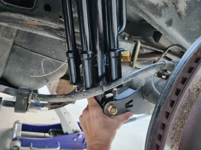

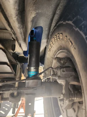

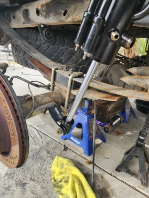

Reference pictures:

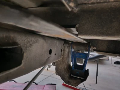

Well too late. I am pretty sure it will just pivot the axle slightly so I am hoping if I change the shackle later it will be negligible as far as shock and bump positions.
