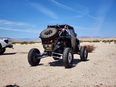

Oh well here is my little golf cart I did last year, it's done so I can get the build pictures up fast.
It's a 2018 rzr turbo s, kinda just a fun safe desert car.

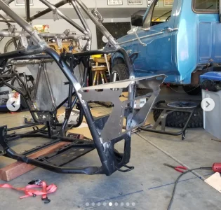

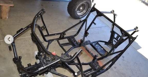

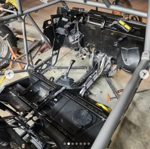

Started off taking it down to the frame: Screenshot_20231226_173737_Brave.webp

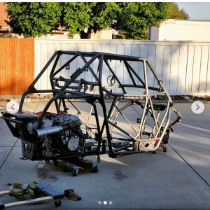

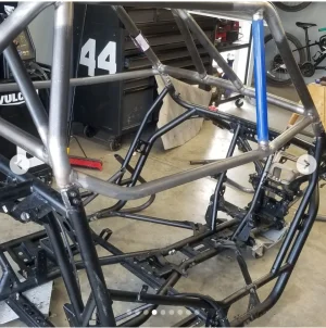

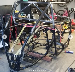

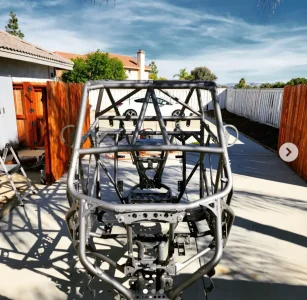

I used a cagewrx wiy cage, it went together really well, I welded it to the frame making it a one piece frame.
Screenshot_20231226_173752_Brave.webpScreenshot_20231226_173800_Brave.webpScreenshot_20231226_173811_Brave.webp

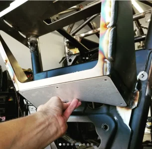

Added a guesst across the two halfs, and the doors are gone:

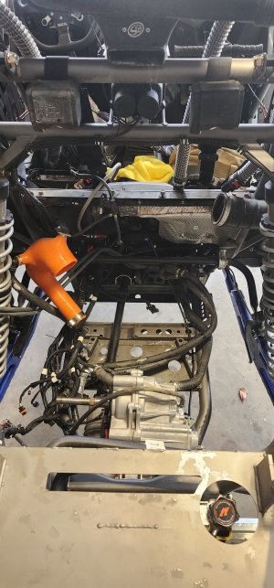

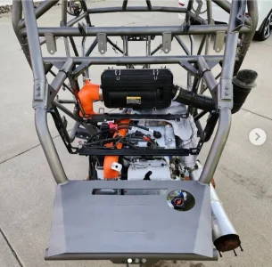

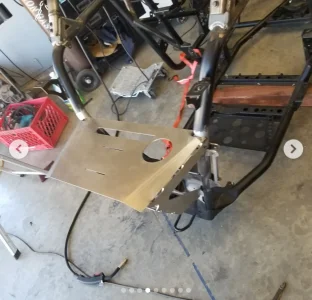

Rear bumper build:
I made it to hold the heat exchanger for the water air aftercooler:

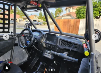

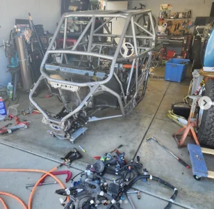

With the tabs pre done the factory harness and interior panels went back in. I added a bunch of double zip tie mounts to the frame to take place of the plastic snaps. Pumper and pre filter mounted.

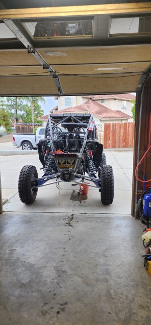

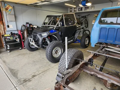

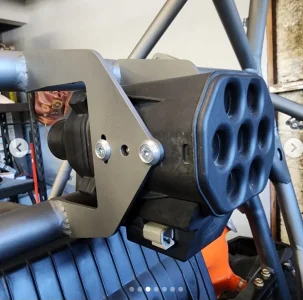

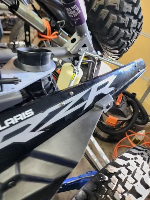

Details on the belt cooling intake, still need a scoop, panel mount borrowed from the sprint car catalog

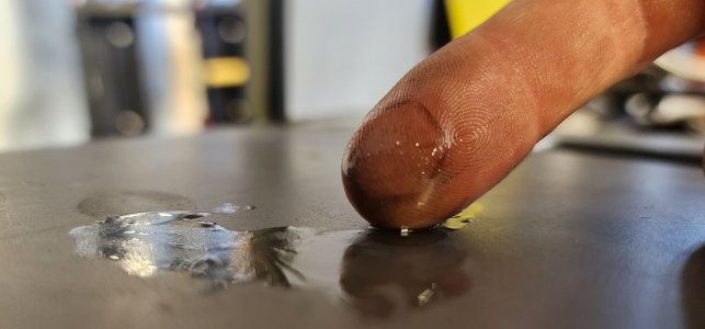

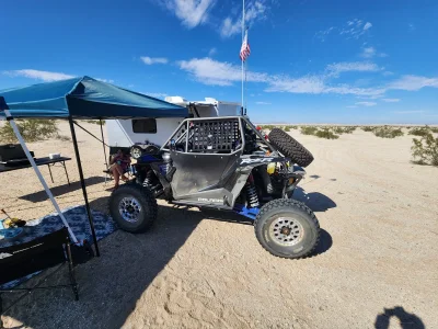

Hmmm the rzr started over heating then knocking and loosing power. After it cooled off it would start and run again. Broke down on the trail but luckily the Ford Ranger beam team towed me to camp. Thanks again <3
Any ideas? I haven't torn in to it yet.
Does it have the underboost/overboost code? Any other codes? Bummer man
I don't have a scanner, but I started it just now and it seems to idel fine, the diagnostics is clear, I'll probably have time to work on it this weekend. So far it doesn't seem like a serious mechanical issue. Must be something with the coolant system I'm thinking. 20241209_181002.webp

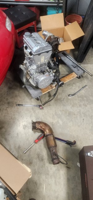

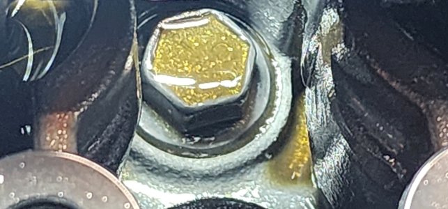

Quick update, this pos has been broken since last season, it ened up being that it spun a rod bearing... I have barely done anything about it since last season but since I am a master procrastinator I am now back to trying to fix it before October and figure out where all these parts go again!
