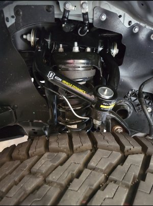

Quick update. Got some Icon UCAs installed today.

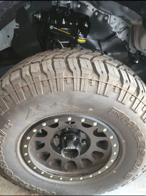

Got some remote reservoir Fox Performance Series shocks on order for the rear.
Last mod will be coilovers. Just need to decide whether I want Radflo 2.5 non-resi or take a chance on the Sway-A-Way 2.5 non-resi.View attachment 1275View attachment 1276
we make a sweet little package for the rangers we actually had a 2019 shop truck which got all of the R&D done on it they are super cool platforms the Tremor rear leaf springs are a huge upgrade over the base model monoleafs
What stroke rear shocks were you able to get in there? I’ve got Radflo’s now but they limit droop a lot. Only so much you can do with stock mounts though.
the rear packaging is horrible from Ford and only allowed us to get a 2.125" diameter they are a 10" travel
