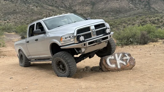

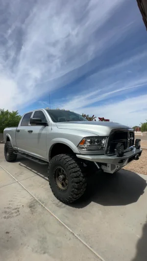

Here it is:
2012 Ram 2500 Power Wagon
  • 5.7 HEMI
  • 8-speed swapped with ZF 8HP75
  • Factory 4.56’s, Front and rear lockers with SmartBar bypass
  • PSC steering box ready for hydro assist
  • Dynatrac Free-spin hubs
  • Tom Woods driveshafts
  • Skids and sliders
  • Thuren front bumper with Baja Designs LP9s and Squadrons along with the factory winch
  • Rear Mercenary bumper
Suspension:
  • 3.0 front / 2.5 rear 2 tube King shocks
  • Thuren Track bar
  • Thuren Drag link
  • Thuren Alien long arms
  • Thuren Coils
  • Thuren Full long-travel replacement leaf packs
  • Boogie bumps front and rear
  • Yokohama Geolandar X-MT 37x13.50R17s on Raceline’s

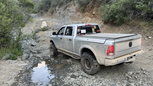

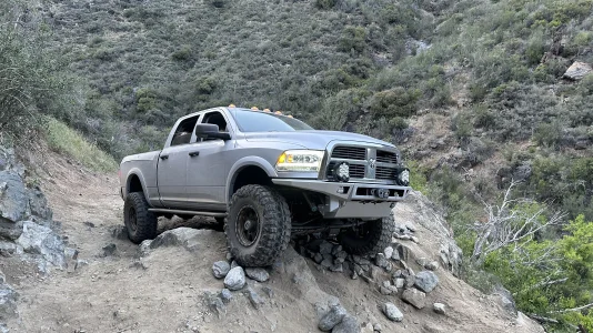

Of course I took it out the first weekend I had it. The only major issue was the transfer case linkage popping out of the bushing. No big deal, I zip-tied it back in and kept going. Other than that, there are a few bugs I want to iron out and some things I’d like to change, but overall I’m extremely happy with it.
