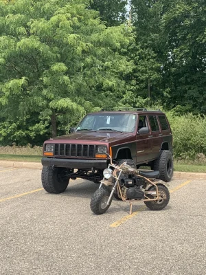

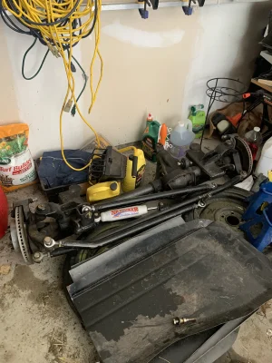

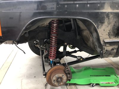

My name is Ryan Cicholski. I am from west Michigan and joined to discuss the Jeep XJ project that I have been working on for 2 years. It is my daily driver, I’ve replaced a lot of necessary items, most notably floor pans as well as installed frame stiffeners. Goal is to put it on coilovers. I have a well-built D30 all set up for coilovers, just want to make it party on factory-ish axles. I am a full-time college student, so time and money aren’t on my side but I’m doing fine. Still need to buy/build a long-arm kit, would prefer to build so if anyone has any tips on how to figure out the right length for control arms and setting up 14” coilovers let me know. Also need to buy the coilovers, towers as well as bump stops and then I’m about ready to fab it all together. Look forward to meeting you all. IMG_1794.jpegIMG_4384.jpegIMG_1472.jpeg
