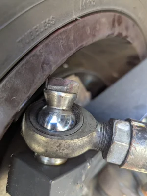

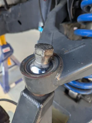

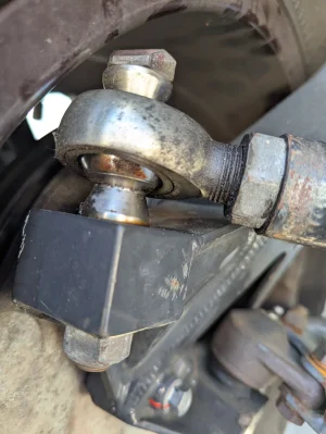

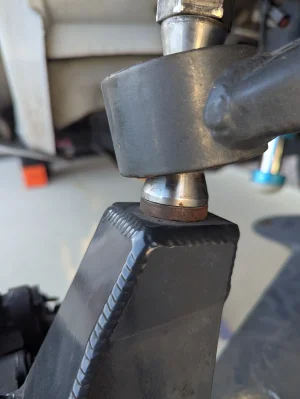

Hello,
So I have a 2010 Silverado Ext. Cab with an older bolt on Mazzulla Kit up front. It seems the Mazzulla spindle was drilled out to use bolts instead of tapper pins for the tie rod and upper a-arm.
You can see from the pictures what is existing. I bought all new uniballs and heims from ProBearing and already picked up misalignments to replace what I had and 12 point hardware.
For the uniball it's a 1" uniball to 3/4" bolt. I figured I would keep the spacer between the spindle and lower misalignment. Is it possible to use a smaller misalignment on the top? Something like the halfmoon ones Dirt King sells? I have been looking but I cannot find anything 1" to 3/4".
On the outer Heim I down sized to a 3/4 Heim going 3/4" to 5/8" for the bolt and a shorter stack height. Could I use a half moon style for the upper stack if I can find one? Would it be better to leave the stack I got and add a safety washer since it is single shear?
Thanks for any help. I'm still trying to learn this stuff.
