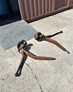

Hey i’m new to this whole building thing i have a 96 ranger that came with a set of bent and reinforced beams that are tabbed for 2.5s i have the whole shock system pretty well worked out but im lost as far as the rad arm pivots the ones that came with the beams have heims on the end and im wondering where to mount them and how do i just replace the cross member or does someone sell a bolt on kit im currently trying to teach myself how to weld so fabing up some isn’t really an option thanks

The heims on the radius arms go into tabs off the frame. These tabs can be welded to the frame or made into a bracket that welds or bolts to the frame. A common spot to have these tabs is near the mounting area for the transmission cross mount.
There is lots of information and pictures on this!
