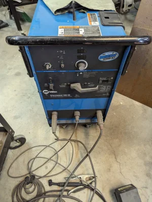

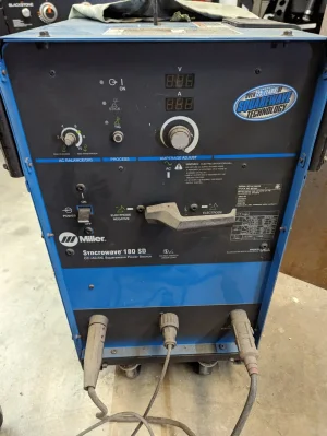

I used my miller syncrowave 180SD for years in my garage and my brother has the same machine in his garage, 240v. I've since upgraded so it's for sale. Need new gas lense setup for the torch but $1400 for this one.

Yeah aluminum takes all the power. That and welding in snouts in a floater is the only time I maxed out my Syncrowave 180 machine.
