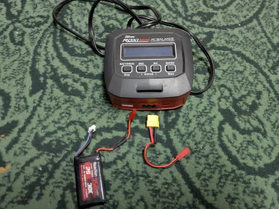

RDX mini. Automatic and its a Balance charger. Tla balance charge is the most important part of any charger for these LiPO batteries. It balances each cell while charging and is way safer than those little USB chargers you get with the scx24.The First generation usb chargers that came out with it scx24s would catch on fire and melt.
I think I paid about 40 bucks for this charger. Factory output of this charger is xt60 yellow connector that you see and I made an adapter that goes from xt60 to jst and changed all the connectors on my batteries to jst. The ph2 connectors seemed cheesy to me.
You can adjust the amperage output along with type of battery you're charging with this charger and everything is automatic. It can put a balance charge and it can put a storage charge and it can also discharge a battery. Has a built in fan.
