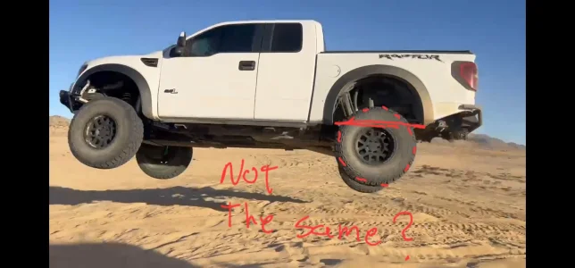

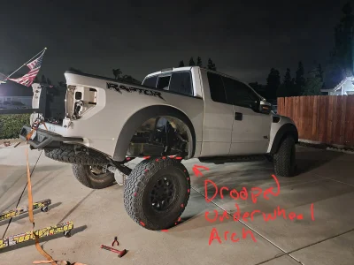

Question.
I seem to have an issue where when I droop out, I do not fully droop out. Do you think my shakle is too long and binding? It dose seem that when I manually droop it with a lift I have to put weight on the axle to get it to max droop.
I figured in real life the momentum would handle this but it seems that its not the case after looking at some videos. What do you think? Shackles? 20240203_183431.webpScreenshot_20251109_164004_Messages.webp
Question.
I figured in real life the momentum would handle this but it seems that its not the case after looking at some videos. What do you think? Shackles? View attachment 45242View attachment 45243
I doubt it, the shackle length looks to be in the right range on your truck - maybe a little on the long side depending on the leaf pack but the arch looks fine at droop, if it cycles smoothly through its entire travel and maintains a relatively normal shape, the shackle length should be fine.
I'd probably be looking at the shocks, I know you welded that bung in down near the bottom of the body, if it wasn't machined back into round the body is likely out of round and causing some binding there, another culprit is possibly the rebound valving.
The valving could be slow enough that there isn't enough momentum un-sprung weight or spring pressure to push it out to full droop, mainly due to the fact that as the rear droops the effective rate of the spring drops significantly and its pretty much just relying on the un-sprung weight of the rear suspension to droop out past a certain point.
That being said, maybe someone with more raptor experience can weigh in, I'm not intimately familiar with these trucks in particular and it seems to me a 6-7in shackle is pretty normal on them.

Yes, look at your shackle length. Without taking everything apart, see if you have leaf separation at droop. If you do, the fix is a shorter shackle, or ideally move your rear hanger shackle hanger backwards.
Yes, I definitely have leaf separation.
I have cycled this pack a few times and I have quite a bit of negative arch going to full bump, the longer shakle helped this which is one reason I have them installed. Also to lower the rear.
So I MOVE the mount aft with a shackle of "x" length would this be the ideal way to limit negitive arch in bump and reduce the separation in droop? I'll definitely research this and reread the OPs info a few more times.
