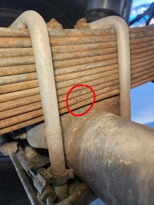

....and the saga continues. In an effort to try to figure out what the heck is up with this pile, I decided to pull the rear bumps, of course they are stuck, likely been in there since day 1 in 2014. In an effort to pull the bumps, I drooped the rear end out to the note of what sounded like the Titanic sinking, so that go me to thinking the leafs were a little crusty and not happy. I think I'll have them looked at soon, they, definitely are not happy. Next was to purge the N2 out of them in an effort to soften the blow. All of this actually made the ride a little more bearable. So now it seems the junk front end is in cahoots with the rear. Well I did my best to ignore all of this because we were going to use this as our tow rig for Thanksgiving, only towing a flatbed with a little RZR and 3 quads I figured we would be OK. WRONG, this was the worst vehicle I have ever used to tow with, I will not tow with this truck again until everything is sorted out. In the end we had a good trip and made it home. I am pretty sure I have a broken/cracked leaf in the Deaver pack, still not sure whats up with the shock valving, front end is still terrible (might hunt down some OE arms and knuckles in the meantime) all in an effort to at least keep us alive and just have a truck that drives like a stock truck.

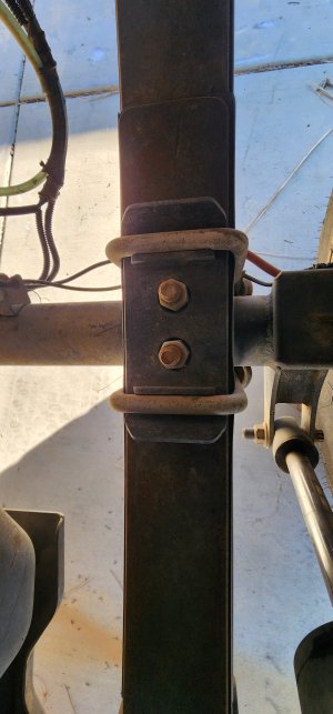

Hey, on the top of the leafs it looks like that truck dose not have a plate to keep the u-bolts from splaying or can I just not see it?
Good eye! It does not have those plates. Just before Thanksgiving I actually checked the torque on the U-bolts thinking maybe there was some movement there. They are not parallel, it looks like that plates keeps them put. Would you mind taking a picture from the top of the pack?
