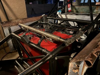

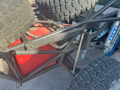

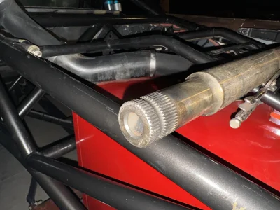

Just seeing if I’m going down a road that shouldn’t be traveled. I’ve seen these sway bars everywhere used for cheap. They range from as small as 7/8” all the way up to 2”. I bought one off eBay to try. The arms are 4130 so I should be able to just use them as slugs and make the rest of the arms.
With that much of a step I’m guessing it’ll break a lot sooner than most other offroad bars. That short end section is going to be doing almost all the twisting.
the only difference I can think of is the movement of off-road suspension is far more more dynamic than a nascar. but if the price is right why not try it
