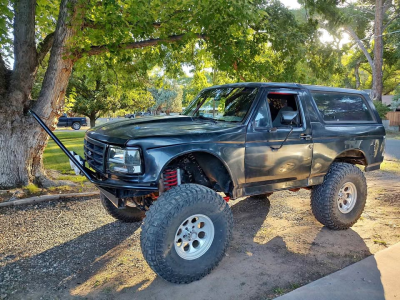

 1972 Chevy blazer full custom build
Engine: 454 with Holley Carburetor
Transmission: Turbo 400
Transfer Case: NP205
Front Axle: Dana 60, Custom Truss, ARB Air locker, 5:13 Gears
Rear Axle: GM 14 Bolt Full Floater Axle, Custom Truss, Detroit Locker, 5:13 Gears
Front Suspension: ORU Custom 4 Link with 13" front Travel, King Coil-Overs and King Bump Stops
Rear Suspension: ORU Rear Drop Down Bracket with 6" Shackle, Atlas Springs for a 15" rear Travel, King 2.5" Shocks and King Bump Stops.
Roll Cage: Done by ORU, Fully Cage To Frame.
Bumpers: front and Rear Custom Bumpers
Dash / Gauges: Auto Metter and Custom Built Gauge Holder
Stereo: custom
Seats: suspension
