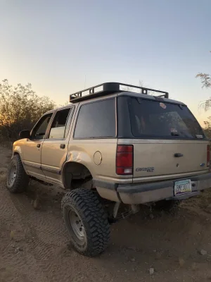

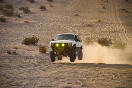

Explorer in question at KOH last year:

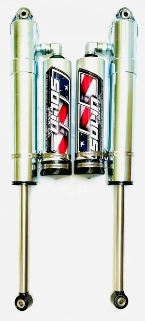

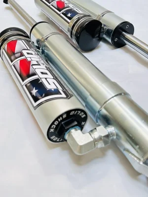

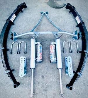

My Giant parts and my shocks work very well. Some guy's need to de-tune the shocks because they can be too progressive if you don't have enough weigh and if you drive it too slow. I have all the parts in stock if you need anything out of the kit?

The compressed length of my shock is 19.75". If you're a little shorter, it can work. I have 2 in stock and I'm in Temecula for pickup.

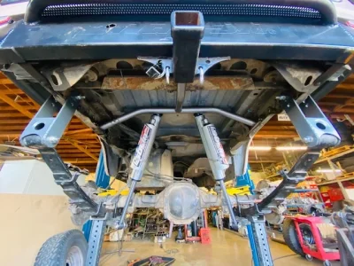

Under cab mount is THE ONLY way to go.
Cookcraft mount and raptor shocks can be had for under 1000$ if you find a deal on shocks and bolt in and be in the desert in an afternoon. He also offers the lower mount that bolts on for 12” 3.0 kings which is a great upgrade as well if you decide to move up from raptor shocks later.

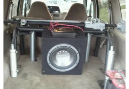

You don’t gain much more droop going 16s through the floor and you loose all the cargo and sleeping area, making the explorer useless, plus you gotta build a bedcage!

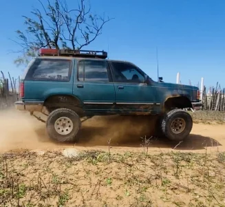

G50e is the only explorer pack. I’ve heard some people ordering “upgraded” explorer springs from Deaver not sure what that is, but I do know, that on all three explorers I have had including my current one that I just put brand new deavers on, they are g50e.

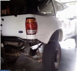

This was my first explorer with a
Bedcage with 16s, g50e, and a drooped out shot.
My current explorer, same spring back, just shocks under the bed. Still droops out quite a bit. I never measured either set ups, but getting to keep the entire rear cargo area is a HUGE positive.

Definetly vote for keeping everything under the bed as others have already mentioned. Cutting holes in an explorer or bronco cargo area for big shocks kinda kills the whole concept of it for me. Just my opinion. But my intended use may differ. I plan to sleep really warm and comfy in the back of my expo, so the Cookcraft under-bed shock mount with raptor take-offs is gonna do it for me. I really like that if I ever wanted to get more shock back there, I can just buy a new bolt-on lower shock mount from Cookcraft and bold in a 3.0x12" King. I don't plan to ever drive the Explorer the same way I do Blanca, but its always nice to leave a little room to upgrade later.
After riding in Ryan's explorer (Cookcraft guy) with his rear mount and Raptor take offs, I honestly have to say its pretty damn impressive. (we beat the absolute shit out of it for two days straight and didn't buck, break, or do anything weird in the rear. I was scared we were gonna taco it a couple times during testing.)
