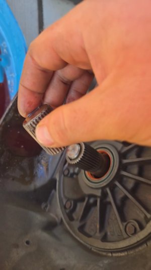

Driveline gurus i need some knowledge.
J.Karrar
Mar 27, 2023
13
Hastings, MI
Took the truck out for its first flight test last weekend and stuffed the slipyoke into the back of my trans and broke something in the transmission. I'm assuming I made the mistake of only checking plunge at bump, ride height and droop. And somewhere in the cycle I have more then the 1" of plunge i thought I had lol after talking to some of the guys at the event I was at they were surprised I wasn't running a 2 peice driveshaft being on leaf springs. I'm curious what the best course of action is, should I take my measurements more carefully and try to make a one peice work or should I build a 2 peice for it.
Truck is a obs ford single cab short box leaf spring, c6 transmission and 9inch rear end. Current driveshaft is I believe 51" long.

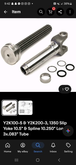

I usually build my own driveshafts and just take them to get balanced. If I'm going to build a slip driveshaft where is a good place to but the parts, never had to build a slip style so im a little lost as to where source the correct stuff
Cycling leaf springs really only gives you a ball park. They’ll move all over the place beer load. 1” extra on the slip with leafs isn’t close to enough. I’d get a 5-6” usable slip joint and build it with extra slip in both directions.
Hard lesson learned lol, transmission is getting repaired and fixed yoke conversion done. Been trying to find a good slip portion, I found one that's 10.5 of slip but it's on ebay and I'm a little leery of it. Not really sure where to find good quality driveshaft parts like that.
