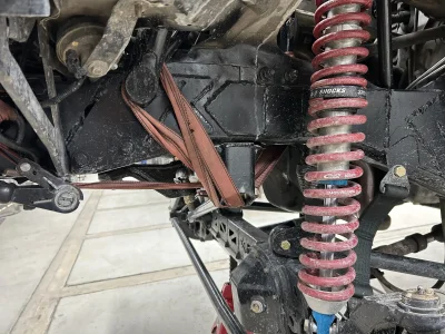

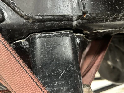

I thought I could just glue a panhard bar mount to a XJ unibody without any additional plating….
It scares the hell out of me that I took this on the freeway…. Luckily it started to give out on top of one of them hills out in JV and not at highway speeds.
The ratchet strap got us back to the trailer lol

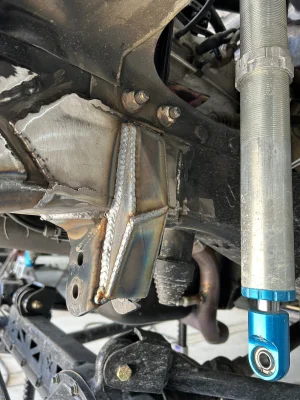

The 2.0 version
View attachment 46773View attachment 46774
