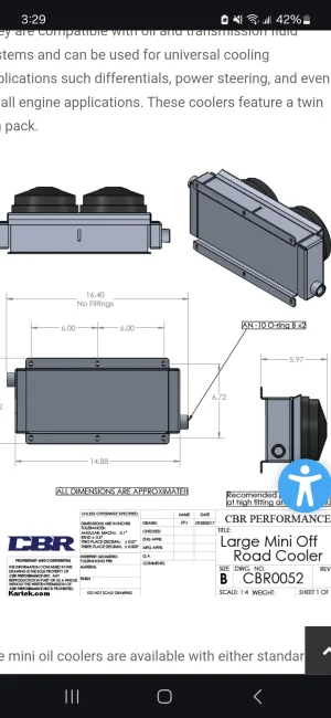

Looking to plumb the oil cooler and need a double male for the inlet and outlet. Diagram shows AN -10, does anyone know what the female thread is?
The thread on the cooler for ORB-10 is 7/8-14, same as a -10 37 degree AN or JIC fitting.
