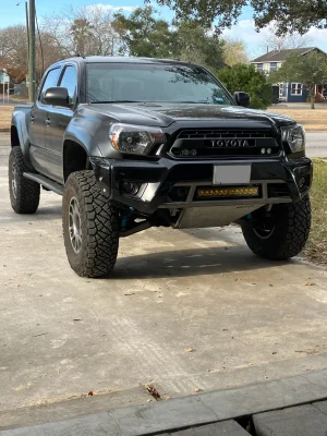

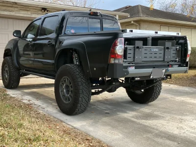

Long time lurker with Zero post but figured it's time to post... My main goal with this truck is to keep it nice and streamlined and light... It's almost finished lol... it has a TC 2" kit up front and a modified JD fab SUA out back. I still want to take it up in the mountains so didn't want to go crazy wide with it so I am making the best of what it is. Next mods will be swapping the rear bumper and swing gate out for aluminum versions ... Any way taking it out west shortly so figured time to post the build and adventures... IMG_1635777.jpgIMG_1637999.jpg

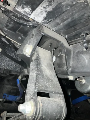

You should be fine... The rear hangers have adjustments I currently have them on the tallest shackle setting along with the HD springs. They also have adjustment on the hanger that allow forward and aft movement which might have a slight effect on lift due to the angle of the shackle. My truck sits tall mainly due to the tires as I have just a slight amount of preload on the front. The truck also looks taller do to the fact that I chopped about 1.75" out of the front and 2" out of the rear fender wells. My Icon RXT full rear spring pack sat about +1" taller than this setup... Hope this helps. Below is a pick of the rear hanger so you can see what you have to play with...
