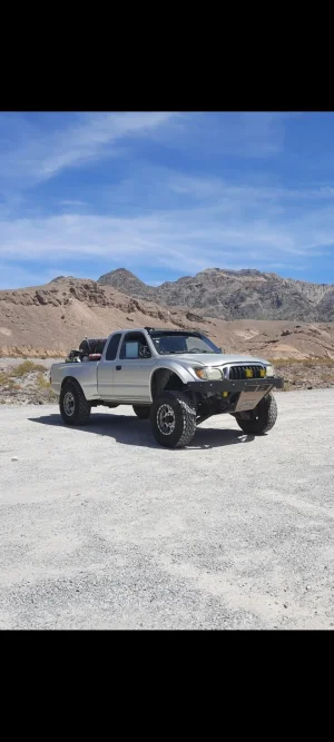

Clean truck. you running a burg kit or something to keep 4x4 or is it a prerunner and wanted a good bolt on kit up front?
alberto
Nov 13, 2022
53
Ventura County
Its a 2wd Prerunner model.
I wanted simplicity for tigth trails. Basic Camburg bolt in kit and Deaver j59 with relocated shocks for the rear.
85Yota
Apr 5, 2022
401
Nice. I noticed a big difference in performance going to a loft spindle which allowed suspension to have more down travel from ride height let it perform much better. My race kit is awesome performance but being 85" wide makes it not as capable on tight trails.
theycallmeWALLY
Mar 30, 2022
1,065
super clean truck man! Are you going to be able to make a build thread on it? Looks like the bedcage area is well thought out from these pictures.
