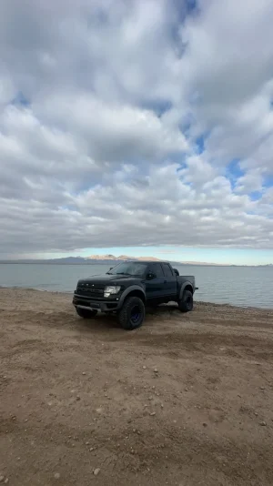

The best vantage point for long distance RC crawling

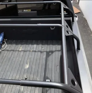

I had been struggling to find a bed rack that looked good and performed even better. Tuff Stuff overland was having a sale on their bed racks a few months ago and it looked like it was almost exactly what I wanted. It was a universal rack so it had a few more moving parts than I wanted. But all three legs were tied together on the bed and it was tubular not super square and overlandy like most racks.
The big downside was it used a smaller tube and set screws to set the width of the rack.
Here's a pic from their website that shows the normal instalation

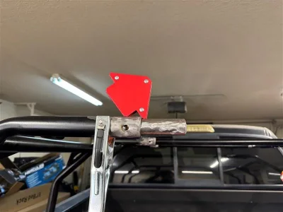

With my previous bed rack experience I knew the set screw would probably rattle out the minute I touched a dirt road. I had also been anxious to use my new welder on a project. So I got some 1.5" .120 wall tube and decided to modify the rack.
I took the 1.25" tubing that was supposed to go in the middle and cut it down into 6" sections. Then I drilled out 4 holes and spot welded the smaller tubing into it
Took some measurements of the middle span and cut my 1.5" tubing down to size. I spot welded the middle tubes to the 1.25" slugs as well
Then I welded it all together and sprayed some black alloy armor on it. I was halfway through a can so I was only able to spray the unfinished tubes. I'll pull it off this summer and spray the whole rack one color.

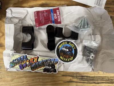

I also got some Wheel Every Weekend mounts during their Black Friday Sale

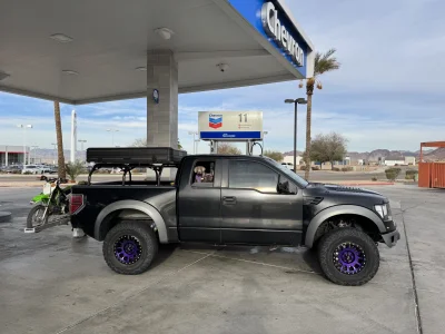

Got the tent mounted on the rack Friday night and started packing up because Saturday we were headed to Laughlin!
Laughlin or Bust

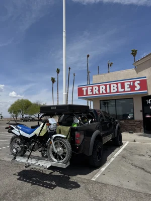

I was hoping the height of the rack would allow me to put the 110 in the bed of the truck...but the handlebars were hitting the bottom of the tent. So I pulled out the hitch hauler and threw it on. Midway through getting the bike on the hitch hauler I realized I could have just loosened the clamps and rolled the bars lower. Lesson learned, I'll try that next trip.

The rack seemed to hold up great. No movement so far, but I will continue putting it through its paces and see how it does.
This thing is awesome. I'm a big fan of the purple wheels!
As for loading the 110, put it in backwards with the tailgate down if you don't want to mess with the bar mounts.
Solid move on opting out of the setscrew option...seen many of them work their way out and the RTT mounted atop is what's holding it all together and square.
