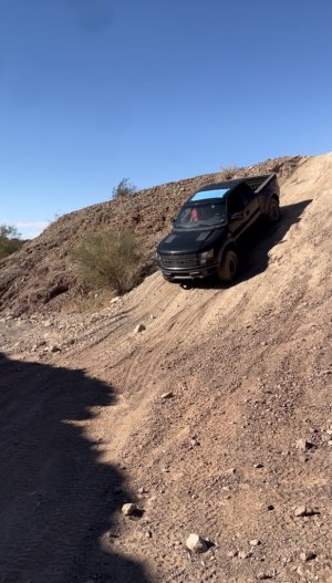

Lafawnduh sucked in the sand. Blown out shocks and stock rear leafs contributed to some horrendous axle hop. But stoke levels were still high. I was off roading in my very own Waptuh!

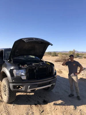

At about mile 14 of the journey, my friend who was passenger princess for the trip said, “wow this thing actually did really good today”....and that’s when things went downhill. Not half a mile later we slowed down to pick our line to climb a fairly steep hill and get out of the wash… and I noticed a cloud of smoke coming from underneath Lafawnduh. We jumped out and popped the hood…

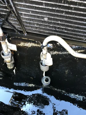

That’s not supposed to look like that…
Ford made these awesome plastic clips that are supposed to hold the transmission lines together. After 264k miles they decided to leave the chat. Both clips had cracked, and one line had completely popped off. It was at this point we noticed a fairly big trail of oil that led quite a ways back the way we had come…
The passenger princess calling for help
We were able to reconnect the line once it had cooled down a bit. Then we nursed Lafawnduh out of the wash to a nearby gas station, but the transmission was not happy. We had another friend come pick us up at the gas station and take us back to town. We grabbed some tools and lots of transmission fluid and headed back to the gas station. We used a combination of zipties and hose clamps from the gas station to insure the line wouldn’t pop off again. I wish I had taken a picture of this fix as it was quite sketchy but worked well. I then hopped underneath Lafawnduh and started filling her back up. 8 qts of transmission fluid later and we finally had a reading on the dipstick! Now I could check “transmission flush” off the preventative maintenance to do list.

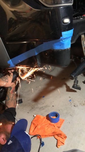

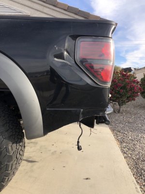

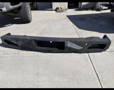

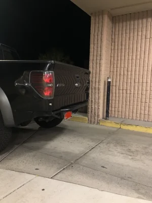

After my first real off road experience with Lafawnduh it was clear I needed to rebuild the shocks. So I drove to SoCal to pick up an SVC bumper I had found on Craigslist for cheap. Gotta look good in the Starbucks drive thru right??
The hideous bumper I took off:

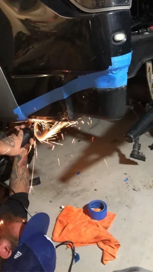

Cutting time:
First side done:
Finished product, ready for Starbs:
Peep the classy custom exhaust( I chopped the stock tips off so I could cut the bedside easier)

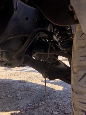

Only thing that broke on the trip was a sway bar link!
So I did the right thing and removed the sway bar. Been running sway bar free for 10k miles now with no complaints lol.

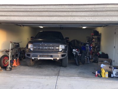

I had the Schrader valve conversion and seal kit just sitting on my dining room table. I had rebuilt motorcycle forks before, but was scared I was gonna be in over my head with these IBP Fox's. So I swallowed my pride and called a professional. Through a mutual friend I found Hutchins Race Prep. Tyler was local, knowledgeable, and just a cool dude.
I squeezed Lafawnduh into the garage and pulled the shocks off
When I pulled the rears I could fully compress the shock and it would stay compressed, no rebound at all lol. I guess it was time for a rebuild.
Tyler said there was almost no fluid in the fronts either.

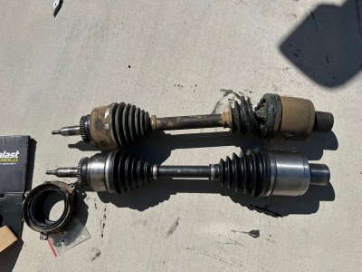

The only real damage from KOH was a torn passenger CV Boot. So I hopped on Autozone and ordered a new one...
It came a few days later and I got to pulling out the old one.
That isn't gonna work...
Turns out even when specifically listed that it will fit a Waptuh, it won't. Got on the Waptuh Facebook group and sure enough, everyone has had this issue with CVs. The only replacements that fit are OE Ford or Yukon. Yukon was out of stock at the time, so I had to bite the bullet and order an OE axle from the local dealership.

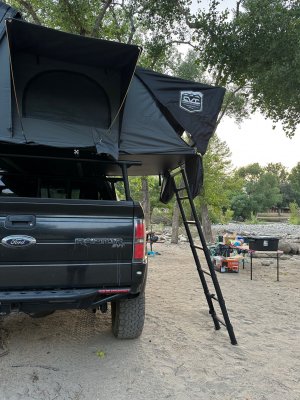

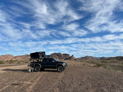

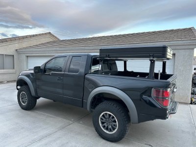

Ever since I got Lafawnduh, I knew I wanted an RTT. So when I saw CVT was having a big sale on some tents they were discontinuing I jumped on it. I got the small Mt Washington. I wasn't particularly sold on any bed rack though. Most were way too overlandish and expensive. So I got a cheap one off Amazon that would work short term until I figured out what I really wanted.
First camping trip with the RTT:
First camping trip with my BLGT sticker:
The bed rack works fine during on road usage. But it is not cut out for off roading. So I am planning on building my own, with much inspiration taken from Wally's bed rack on his Ranger. He uses his truck and it looks like his GFC hasn't fallen off yet so I'm sold.

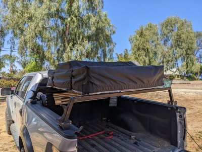

keep eyes on the spot where your tent mounts to the rack.
Idk if that CVT is the same as smittybilt, looks pretty much the same, but the measly little M6s will tear through the bottom of the tent. I ended up drilling a bunch more & adding fender washers and got it to stay put like that eventually.

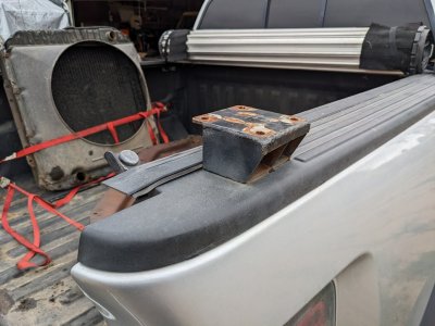

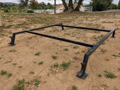

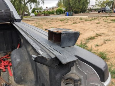

You got any pictures of your bed rack?
I built it to work with my Bakflip revolver tonneau cover. there are 4 base pedestals that clamp to the bed rail & the rack itself bolts to the pedestals.

Couldn't re-boot it? Anytime I have an OE CV boot wear out I will just get an OE boot and re-boot it. 99.9% of the parts store cheapo half shafts are garbage...even if they fit.
Definitely interested, just need to figure out if I can make it out to SD anytime soon.
Due to the mileage on the truck I figured it was time for a new one. But I did keep the old half shaft and am planning on rebooting it and keeping it as a backup
