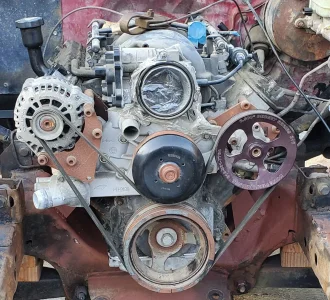

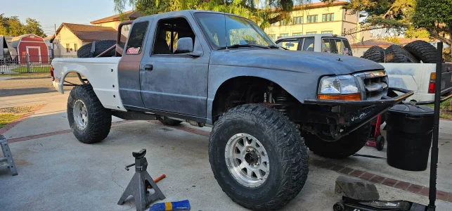

Figured Id start a new thered and catch up where I left off on Dr.

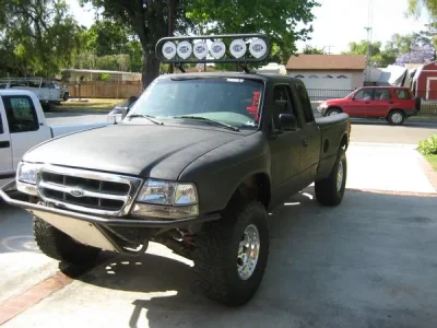

Truck is a 98 bought it pretty much stock in highschool.

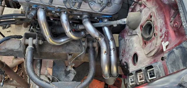

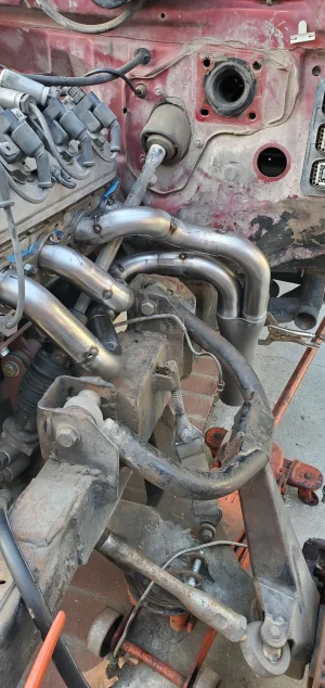

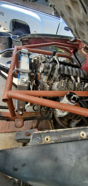

Motor is a stock 5.3 from a 2005 Silverado
4l60e with a full manual conversion

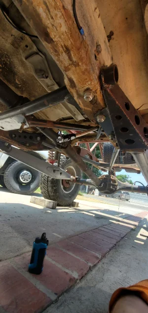

Front suspension is a camburg race kit 2.5 coil over and bypass pumps off the upper arm
Rear is a camburg 3 link 31 spine full floater on 2.5 shocks.20240921_180127.jpg20230813_105746.jpg
First question of the forum yes I sorta searched couldn't find anything. My power steering fluid is overheating. Just not sure if it's to much pressure or not enough cooling. But I'm using a howe t/c pump and it's plumbed In to the stock Ford ranger rack. Currently using the stock cooler. Have a psc reservoir with filter and the fluid got so hot it melted the breather hose out of the cap
