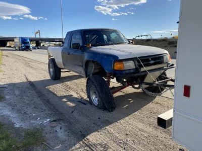

Some trip pics from October 2025 in Little Sahara Sand Dunes. The rear shock set-up worked the best it ever has. It kept closing the rebound tube and it was getting better. I think I need to stiffen the rebound a little now. Then I started losing first gear. On the way home I had a KO2 blow out, happened to look back and see black chunks of tire flying. Only damage was broken a RV tailight housing.

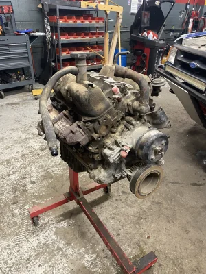

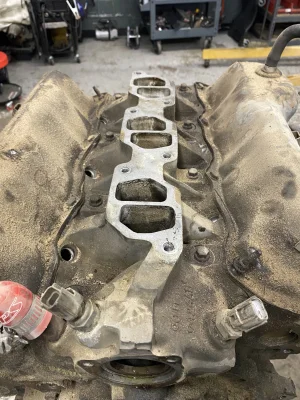

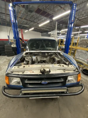

More recently she started burning coolant this past week, and threw a cylinder 6 misfire. So ill be rebuilding and upping the compression ratio from 9.0 to around 10.0 and maybe a cam.
