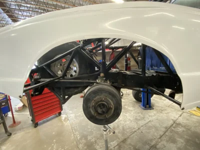

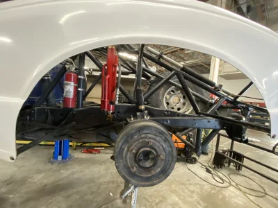

More re-doing of old bad designs, with less bad designs. I needed to change my bumpstop pads in the back because they were small and the strikers were getting destroyed. I am also bumping it one inch higher, I had a little shock travel left for droop in the last setup. Also got lucky with where I put the bedside tubes, gets a little close.
1/4” flat bar
Trail Gear u bolt plates
Fancy 1/2-20 12 point nuts for the U bolts
Yeah any articulation they twist the Bushings and swing side to side.
Yeh, I think axle wrap is the biggest issue. Now the contact area is a little bigger, I gained about 1" of uptravel, and the shock will be way easier to install without trying to compress it. So more updates to follow in prep for a trip to Little Sahara Sand Dunes.
