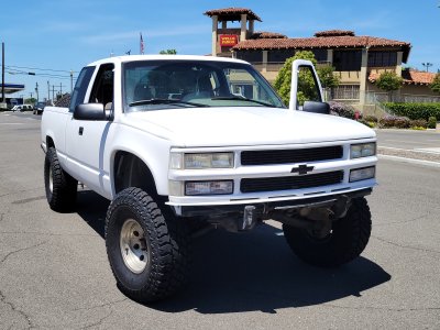

I'm not much of a writer, so bear with me here. I've got a 1996 Chevy C1500 Extended Cab that's been through quite the transformation - what started as a bone stock 2WD truck is now running a solid axle swap (SAS) with a full 4x4 conversion.

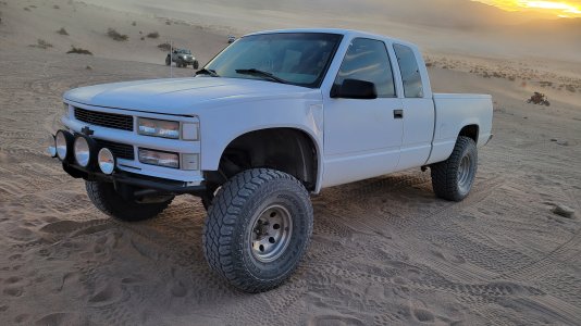

Once I started making a little extra money, I got the itch for an OBS prerunner build. Keep in mind, this was still a 2WD truck at the time. I knew I wanted to hit the dirt, but I had no idea how far this build was going to go.

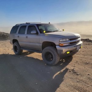

I ended up buying a 2006 Chevy Tahoe 4x4 and threw a Rough Country 6-inch lift on it with some Patagonias. Pulled the sway bars off and started hitting the trails with The Dirtnation offroad crew. I was having a ton of fun until I broke an axle out at TDS in Ocotillo. After seeing how rowdy people were getting out there, I started really looking at other rigs and realized that Tahoe just wasn't going to cut it for what I wanted to do.

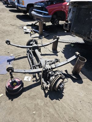

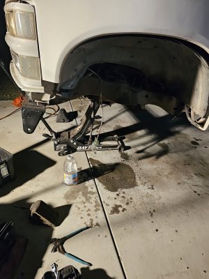

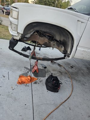

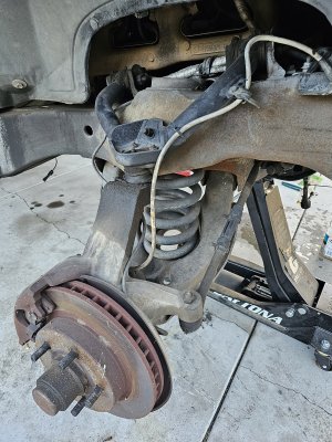

I started with the suspension, knowing that "leaf springs party harder" (shoutout to Loose and Lost) and they'd be more budget-friendly and possibly easier to install. I knew I needed tons and 40s to do what I wanted to do. After doing research, looking at images of other builds similar to what I had in mind, and spending time on forums, I decided on '99-'04 Super Duty Ford axles. Being driver-side drop meant minimal modifications - seemed ideal for what I was trying to accomplish.
The Junkyard Score
Hit the junkyard again and started looking. I found a matching set of axles front and rear off a 2000 F250 Super Duty and pulled them. The front axle is a high pinion Dana 60 with 30 spline and stock gears, and the rear is a 10.50 Sterling with 35 spline axles, open diff, and stock gears.
TO BE CONTINUED..........
