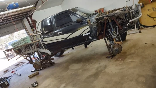

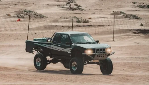

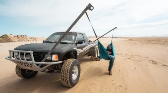

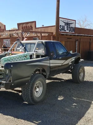

I have zero info on your valving question... I only came in here to ask you to post some pics of your truck!
Lol no problem I'll do a post later on the build.
