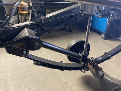

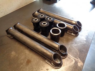

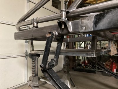

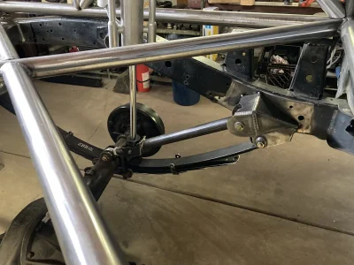

Here’s a couple pictures of the rear leaf setup. From All Pro, their long travel springs, they were super cheap when I bought them but have gone up since like everything else.
Little shorter out back than Deavers but still have decent travel.

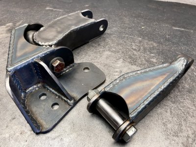

Weird bushing inner and outer diameter size though (OEM metric inner) so made some delrin bushings for them to run thick wall inner inner sleeves because that’s just how I like to setup my leaf springs
TC front hangers salvaged off the other pickup
These aren’t the shackles on this truck or delrin bushings I made (they’re a longer set I made for a friend) but you can see the inner sleeve size I like for leaf spring bushings
Pretty sure it’s 1” .219 wall for 9/16 bolt ID

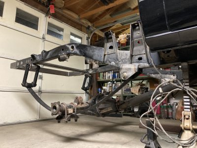

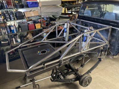

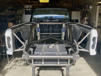

Changed up the back of the frame section to some nice clean rectangular tube
That’s the cradle for the fuel cell and you can see a little of the bolt on bedcage
Was trying to keep the stock bed but the 2wd beds and wheel wells on the 80’s pickups ( maybe 4wd too ) are built pretty unique compared to later toyota beds and are pretty hard to use with fiberglass bedsides
Idea is building a removable tube bed that will be plated/paneled in for storage and utility

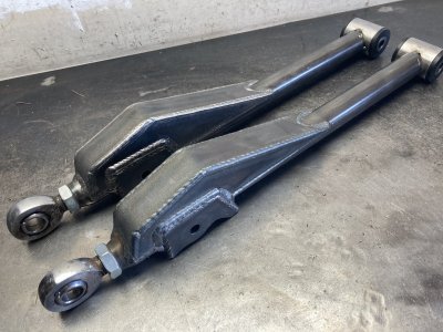

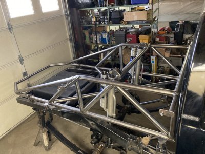

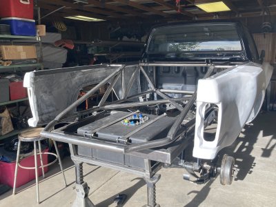

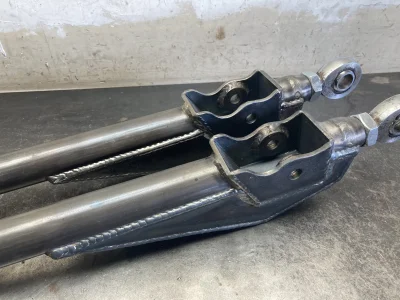

Here’s up to date of the back of the truck

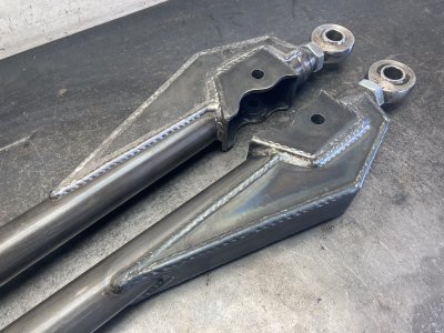

Wanted to do trac bars like this for a while
Lots of time cycling to get the best geo for the trac bars to limit binding
Saw a build somewhere with trac bars on a ranger and the shocks were mounted off them so I thought I’d give it a try too
Gets my ratio away from 1:1 a little and should help with shock travel speed
Think it will be easier to tune and make the ride nice and soft

What thickness tubing did you go with for the track bars?
Seems like they would take a lot of stress and load which is why I'm asking.
Looks great and I'm sure it cycles perfect.

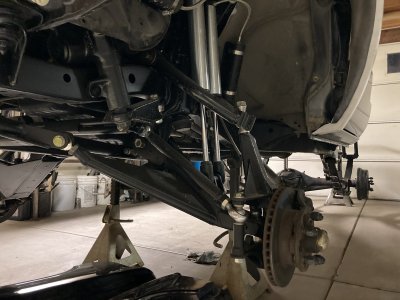

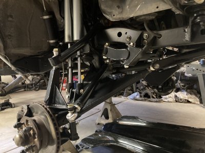

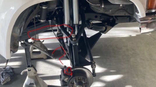

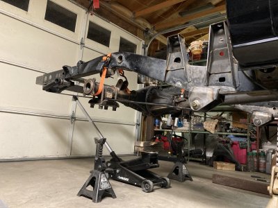

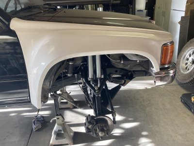

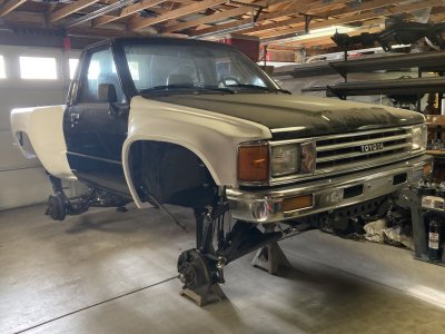

I’m totally missing something here. Is that a torsion bar front kit? I don’t see the torsion bars or room for coils.
UR_Mawm69
Apr 13, 2022
343
Yeah torsiin bars, you can see them behind the limit strap clevis in the 2nd to last pic
is this them?
i seriously don't know anything about torsions. i like pussy, not da diq. so me no no???
